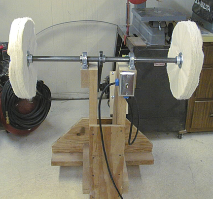

Klingspor sells a 1" by around 36" double-ended mandrel for around $90
that includes the pillow blocks, a pulley and pulley shield. It's a great
deal. I can't find it on their web site, but it's always shown in their catalog.
I have 14" buffs on mine. Every time someone raises this question I post
this pic, so I'm sure folks are getting tired of seeing it!
IMG]
PostPosted: Fri Jul 28, 2006 5:44 am
Craig, did you get the 14" buffs from Klingspor as well?
