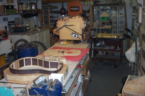

HESH! a gobar deck on wheels, I see round and flat gobars ay? Nice.

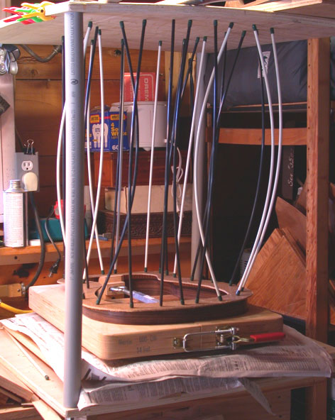

TODD! wow, your deck is so accessible, very nice, plus you have a storage rack and a GOBAR QUIVER, that rates.... holy mackerel is that a DISH RACK on top? man o man, you gotta supply some plans for this baby.... and adjustability in the REMOVABLE BOX for doing tops and backs on the bodies.... (now what can I get rid of in my shop to make room for one of these?)
PostPosted: Wed Aug 02, 2006 12:31 pm
Hesh...Great setup!!! Did you glue up with what we discussed? Take courage, Bro!

[QUOTE=Hesh1956] Here’s my go-bar deck and how it looks as of 10 minutes ago……..
I built it with enough room inside to use for installing backs and fronts on even d****n****ts.
Wow, Hesh, you're building DONUTS!!??? Cool!!
Mine looks like Hesh's only without the wheels. And that sander piece up there on the top part. I'm still working on that.

I built this...
with this....

Mine is like a compromise between my Brother Hesh's and my brother Todd's, it's got wheels and bottom shelves storage!
Here's the best pic i could find, it's on the far right side
