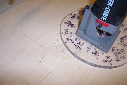

I do my rosette a la Mario's with a piece of plexiglass that i attach at the bottom of the dremel and decide where i want the diameters to be pivoting from, here's a pic
Serge Poirier38933.6810069444

I own the Porter Cable 7310. It is a great tool. I really like that base you have on it. I'm going to have to make one of those. That must save a ton of tine in set up.
Do the dimensions on your base indicate center to center for the cutter and the dowel, or is there compensation for the cutter and/or dowel.

Steve, sorry for the time i made you wait, i'm still at work!
Yes, i measured from the center of the cutter to the center of the dowel, but one could make measurements with compensation in mind yeah.
This jig was inspired by Mike Tobey's jig, purchased at Lee Valley Tools, here's a link
http://www.leevalley.com/wood/page.aspx?c=1&p=40970&cat=1,43 000
Making one is so simple, especially if you want to change diameters often
SergeSerge Poirier38933.7049074074

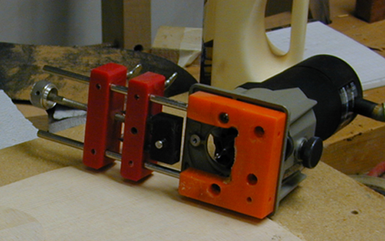

Here is a picture of my LMI fixture. I don't think it would adapt to the laminate trimmer - or would it?
PostPosted: Fri Aug 04, 2006 8:31 am
Steve, 1/16" is good enough, i'd recommend you buy one of them tools from Lee Valley's, it is made perfect already so the guessing is avoided when measuring, i did mine because i felt soooo dumb after breaking that one that Mike Tobey had sent me and was dang broke!
