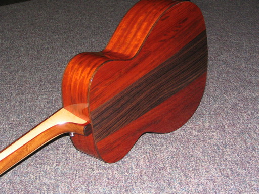

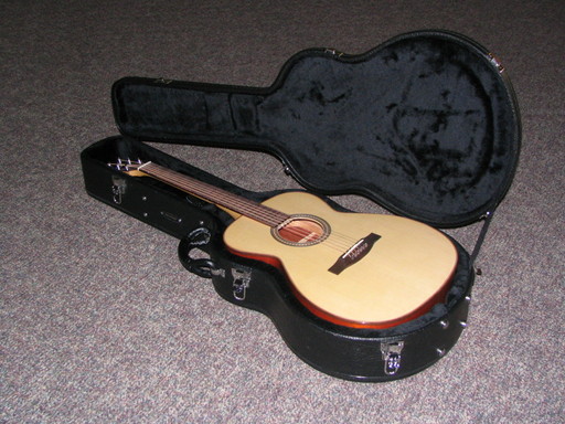

here is build #4. hope the pictures work.
it's a slightly swollen OM (i'm calling it a Grand OM) - a shade wider in the lower bout, tighter in the waist, and deeper.
the bracing is 1/4 inch, X braced like a typical martin copy.
the scale is 25.4.
engleman top.
padouk and e.i. rosewood back and sides (sides are lined with maple veneer for extra strength with almost no extra weight)
5 piece neck (maple, pad, mahogany, pad, maple). the padouk was left over from the back pieces.
madagascar rosewood binding with padouk, cocobolo and white purflings.
the mosaic rosette is from lmii and is meant to be a bit of a nod to larivee (the godfather of canadian steel string building) and as such, also a nod to what's become an incredible community of canadian steel string builders.
bone nut and saddle.
e.i.r. bridge, fretboard, and pins.
ktm9 - rubbed out by hand (my arm almost fell off!)
gotoh tuners.
looking at it now, i think the back looks a little blingy, but the guy that's getting it will know he's got a one of a kind, and more than anything, he's going to love that the sound is even, bright, and HUGE!! (if i do say so myself).
so thanks for all the advice along the way. and thanks too for the generosity of some awesome professional builders who have been more than generous with their time and advice.
phil

I love Padouk, and paired with Indian it looks great.
Not too much bling for me, that's for sure!

Nice job on the guitar and I think it looks great!

Nice effort and creative design...I like it!

Now, I realy realy like that neck combination of yours. Looks great.

that guitar is just amazing! I love that neck too!

Wow,That paduak jumps out at ya! Real nice guitar!Beautiful! And Welcome to the OLF

Welcome Phil and thanks for sharing the pics, nice work.

Nice guitar!

I really, really, really like the way you did the neck on that one.

Welcome, Phil. Very striking guitar. I really like the neck concept. Looking forward to your participation here, and to seeing more of your work!

Very cool guitar! I too love that neck and the back looks very good...
