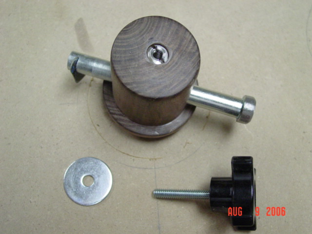

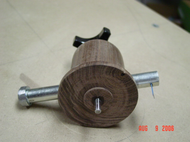

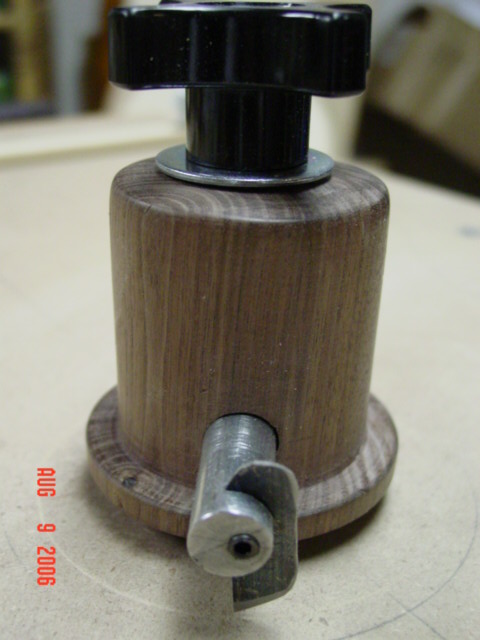

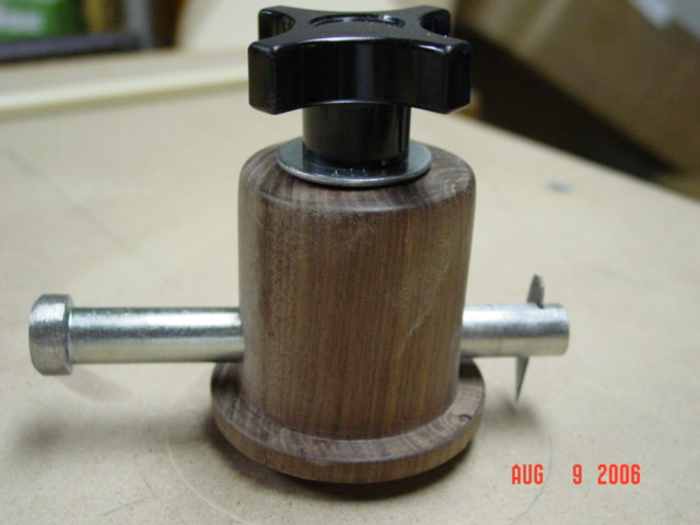

Brian,
Here's a few photos of a rosette cutter I made modeled after some of the other forum members designs. (Can't take much credit...)
Cut the inner and outer radius (carefully) and you probably can use any type of router bit you prefer.
I used a 1/2" bolt, a scrap from a walnut spindle, a 1/4-20 studded knob from my jig box, a threaded insert, a 3/16 pin and then made a few blades from an old hack saw blade. The only time consuming part was drilling and tapping for the small set-screw.
Cheers,
Pete
Peter
