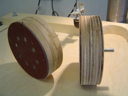

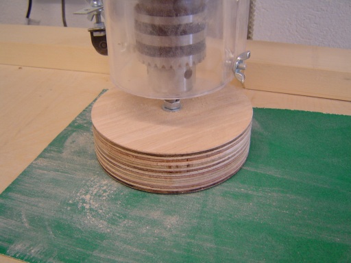

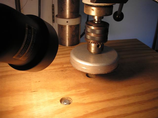

PostPosted: Mon Aug 14, 2006 8:21 pm
After using the Wagner for thinning plates, I use a drill press sanding disc, as others have said. They are very simple to make and I have a set with different grits on them. I can probably make one in 15 minutes from scrap. The only thing I have ever had to buy is the vecro for the base and of course the sandpaper discs themselves.
I usually just take it through once or twice each side with the sander just kissing the wood to remove any marks from the wagner. However if the wagner is sharp and the table well set up there should be only very faint marks to remove. Final finish is with the ROS and scraper (always finish with the scraper).
By the way I always thin my tops with a hand plane, one of my favourite jobs.
Before fitting the velcro level the bottom of the disc by rotating on sandpaper.
