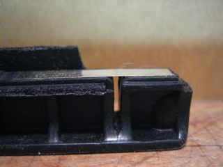

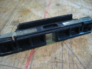

PostPosted: Wed Aug 09, 2006 6:37 am
Posts: 2060
Sorry it took so long to get these posted. This is the base portion of the ibeam. The top section just has a piece of circuit board with the wire connected and is pressed on to the piezo film to secure the connections. Unfortunately that part is lost somewhere in the bowels of my shop right now.
This is a close up of one side. On guitars with a tight X-brace angle I have never had to clip more the the corners of the base. I've never had to clip the vertical center section, and that is where you might start to effect the response. From what you described, a quick nip on the corners of the flat part of the base and a little of the vertical leg (the part perpendicular to the length) at the end will probably give you plenty of room to move it forward enough.
PostPosted: Wed Aug 09, 2006 8:49 am
Thanks David!
Now, just so I'm sure that I'm looking at this corredtly...it's facing "up" in your photo...the way it'd be attached to the underside of the bridge plate...you're saying DO NOT cut anything along the longitude of the pickup, only angle the corners on the side of the pickup facing the soundhole, to snug up into the X-brace?
