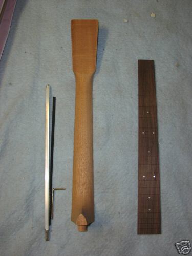

Martin channels run shorter. Here is a picture from John Hall's eBay auction for necks to show a Martin neck, the channel and the rod. You can see by the picture the approx size of the truss rod in comparison to the channel.
