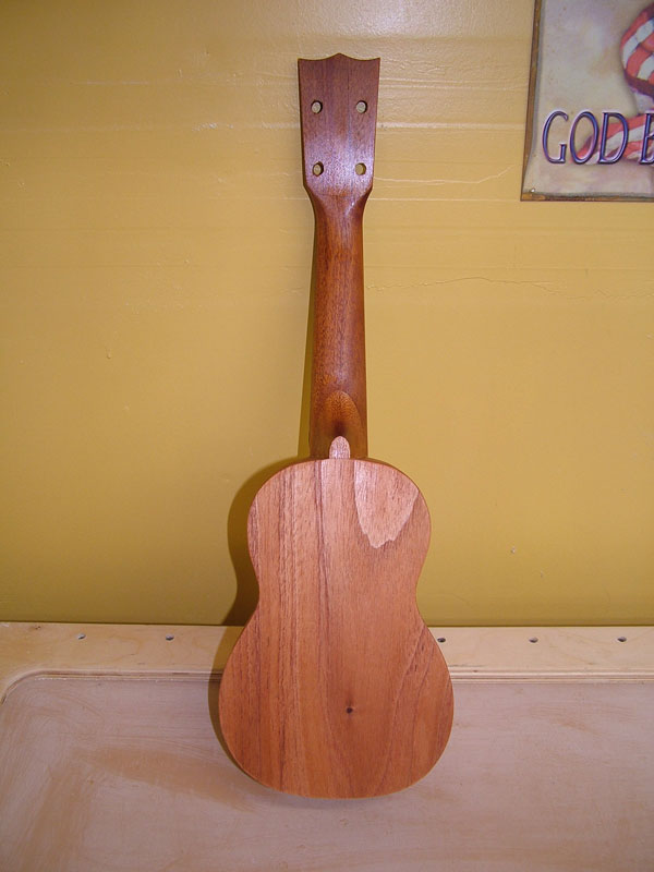

I built this uke from a kit using the methods described therein to make sure that students could do the same and to see what problems they would encounter. The only embellishment was a standard label and a brace that I replaced because the one provided was cracked.
I've been chuckling for a few days now, it's nice to be able to build something in the shop again. I think total time on this kit was 1.5 days, I actually would build on it during breaks from work, it'd be 10 minutes in the shop and then out to do other things around the house while glue dried. It's a cute little bugger to be sure, I thinned the edges and shaved the braces a little because I didn't like the way they sounded, it has a pretty good bonk tone.

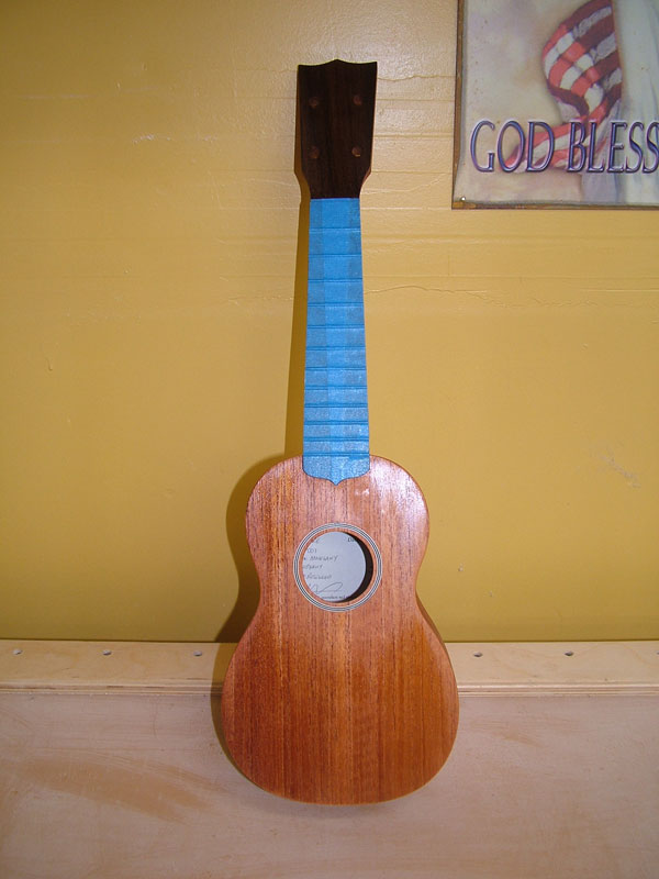

The pictures are with the tape on the fingerboard ready to ship out to Addam on monday to get finished, I applied a light coat of shellac to make sure I didn't miss any sanding spots. It will look much better one Addam does his magic on it

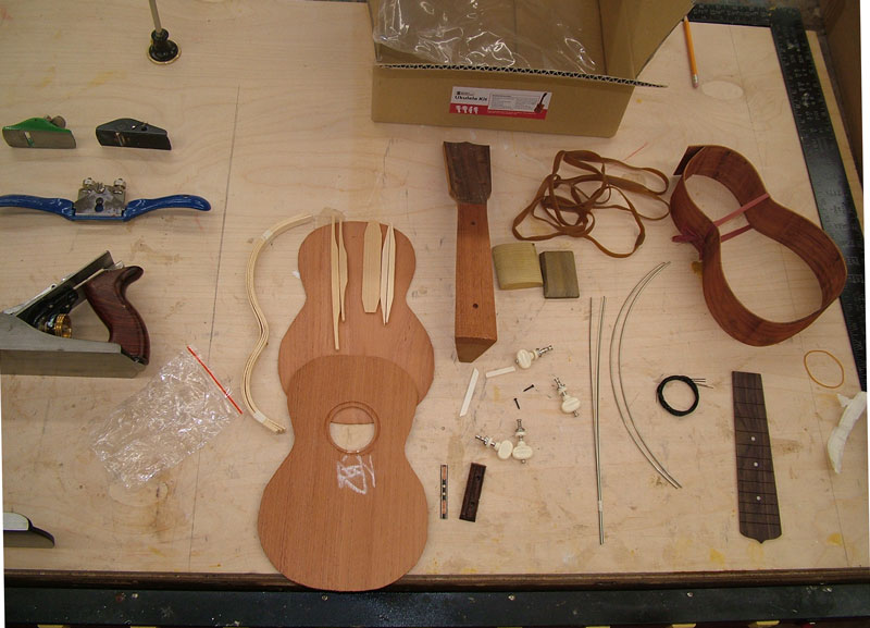

I was not very impressed with the kit overall, I had to fix a brace that was cracked, the linings had some holes in them and were not bent very well. The bridge bottom was not even remotely flat, nothing that I could not easily fix. The instructions where good and clear, the back had a small knot in it and I would have not put it in a kit given my choice but regardless it wen't together fast and looks pretty solid. The guitar label is humerously HUGE in it
Let's see I sweetened the neck a little and to my dismay discovered the neck was not flat, but I'm confident now that I can teach a class on instrument making and build these in three days with no problem and that was my goal.
