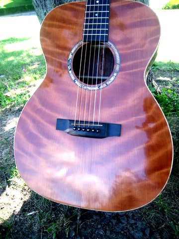

Well I am about finished with this build. Posted some pics of progress some time ago and thought I would post a few of the finished pictures
Nice redwood top. When I first got her all assembled and played (prior to finish) I thought "Man, what a dog this thing is" - the sound to me was horrible, no volume, no treble - it was just plain bad - or so I thought.

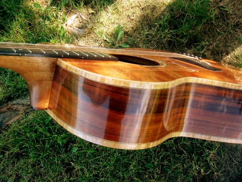

Anyway, I went ahead and finished. Have roughly 8 coats of lacquer - 4 in one shooting, set for a couple weeks, sanded with 600, applied another 4 coats, let sit for a few days and then sanded and polished.
The redwood is stunning - although my patience level still has a ways to go. I should have drop filled some of the divits and areas where the binding meets but so anxious to finish that I went right to sand and polish - so I do have a few minor finish flaws. Maybe someday I will play with them some more.

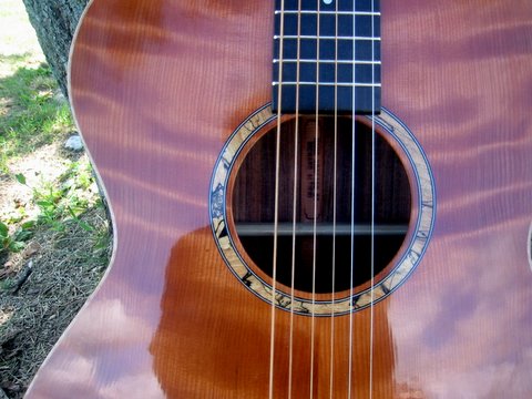

Really pleased with the Spalted Maple Rosette

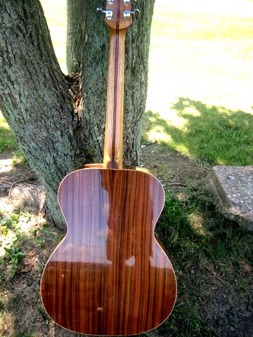

Pau Ferro back/sides with Maple bindings.

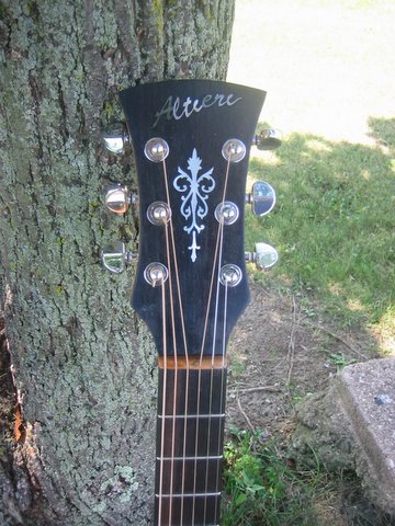

Not sure if you can see it, but still have some trouble with inlay showing edges where routing is a little off. I mix eblny dust with Titebond and then for the smallest divits, filled with a little CA. I dont know what I am doing wrong because I have done this in the past and the outline of the inlay was really invisible. Now I can see where I filled.
Oh, almost forgot - the sound. Not sure what the heck I did, but once it was all assembled and polished, the action was dean on perfect and the sound has gone from being a dog to being actually quite nice. I often hear stories about how the sound will develop and I have to tell you the change on this one was quite drastic.

BTW, I used Adirondack for the bracing on soundboard and back. Ebony fingerboard and bridge. Martin Marquis lights for strings and some kind of fosil something for saddle and nut (was a gift so not sure what the heck it is).
Think I took the soundboard to around .105 and same with the back. Sides are around .08

Rich -- whoa it looks great! Nice combo of sides/binding/top and killer rosette!
About the ebony filling I am wondering if it was the combo of dust and titebond that is causing less than desired results. I fill all of mine with dust/CA now and am not particularly careful about which part of the board the dust came from and pretty happy with the results.

Love that laminated neck, rosette and your headstock design! More pics Pleeeeeeaaaaaaase!!!!!!!

Rich that's a real beauty my friend. The maple guitar sounded great too. Try using fine ebony dust and fill the cavities high then flood with ca.

Great looking guitar Rich. Leave out the titebond and just fill with ebony dust and CA. It'll be much better. Just fill with dust and then flood CA. But don't use any excellerator.

   I've tried CA and dust, PVA and dust and epoxy and dust. To me the epoxy gives the most invisible fill.

Ron, I've found epoxy leaves a visible shiny line that can be a slightly different shade.

Stunning top and wood combo all around... I really like that rosette!!!

The finish is glass-like which really pulls the grain tones front and forward in the redwood.

Wow!!! Thanks guys and gals for the words of encouragement and all the feedback on the inlay approach. Really appreciate it.
I will be practicing with some ebony and different methods to see how they work out. I did try dust and CA in the past but my AAA personality applied activator because I didnt want to wait for cure. It left white spots and I know why!!!!
In any case, I will be playing with this a little and will report back based on all your feedback.

Oh that's nice. Lovely rosette.

What a beautiful guitar...I love the matching neck stripe with the guitar's back wood...really classy.
The STUNNING wavy shimmer in that top wood grain almost denotes the type of tone the guitar would have...
