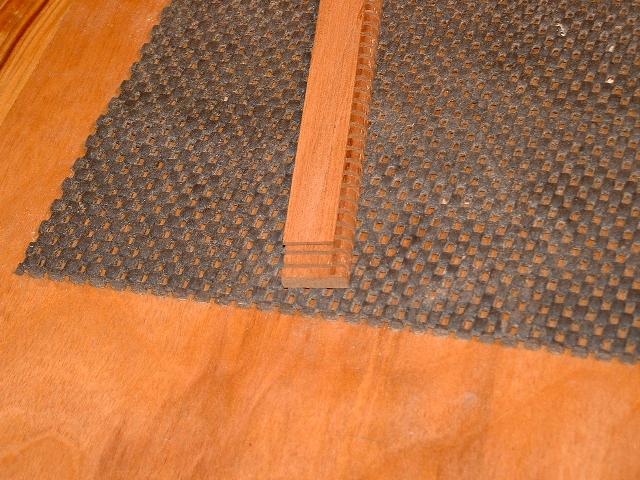

PostPosted: Sun Aug 20, 2006 2:48 am
Posts: 170
Heres is a picture of the capped lining that I was
talking about.
Keep in mind this style takes twice as long to install
glue in the kerfed part,let the glue set, then glue
in the cap. Extra steps to make them also.
As I said before this style sure is stiff
you can take out your spreader once they are in.
If they do improve tone, I don,t think you would notice
the difference. I do like the way they look,but plan
on using them only on my most expensive builds.
Tom
http://www.moriciguitar.com
PostPosted: Sun Aug 20, 2006 2:52 am
Thanks for finding this pic for me Tom, i understand better now, yeah they look plenty stiff all right but as you say, better to use them on high ends guitars!
