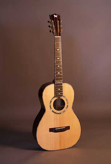

I have built one O size 24.9 scale 12 fret. It is a nice little guitar. Perfect
for a young one.
I made up my own design since I didn't have plans for that scale length
and a 12 fret. It is all a matter of figuring out where the bridge is and
then working it from there. I probably over braced mine though
Attached are picts of my 0 size 12 fret 24.9

Andy very nice guitar there.

Andy, WOW, what a beautiful little one!

Nice Andy!

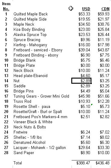

As for cost -- this is the first time I've done an estimate as I was curious as to what it costs to actually build a guitar.
Anthony Z38950.6784837963

I used plans from a LMI (? Antes) 12 fret Parlor but I changed it because my
O body size was a bit bigger and I went with the 24.9 scale. As far a sound
hole, mine was a bit big.
I have never seen any printed plans for an O size 24.9.
After I got the mold from John H. I traced out the body size on some paper.
Then based on scale length, marked out the bridge position. I used around
a 95 degree X brace and single tone bars and finger braces

Anthony, you're too quick for me! Thanks for that price list bud, it will be interesting to build the same model as you will build!

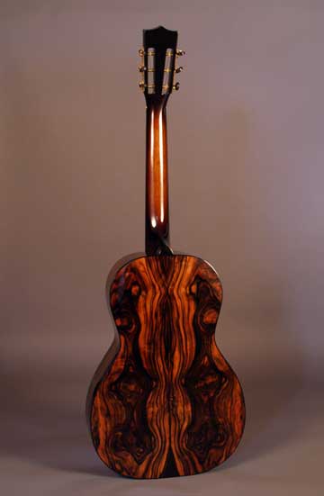

WOW Andy, where did you get that beautiful wood?

I got that Zoot from LMI (Macassar Ebony)
