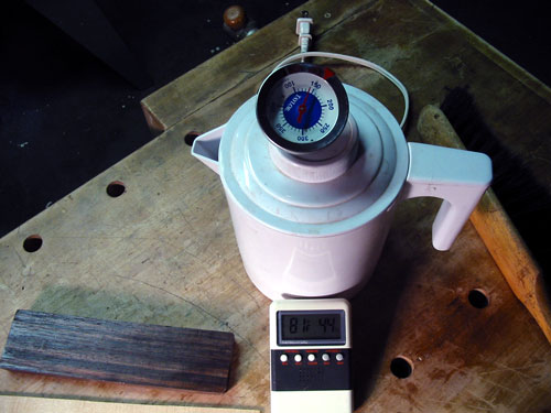

I did monitor the temp of my rival hot pot but did not measure the amount of water I used. I just added water until it was just a little over the top of the glue.
My shop was not quite as warm as the photo indicates there was a portable light shining on the thermometer. It was actually about 77 F. and as you can see the HHG was about 140ish.

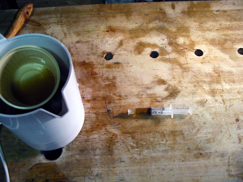

The mixed glue looked like this and I used an oral syringe to dispense the glue with.

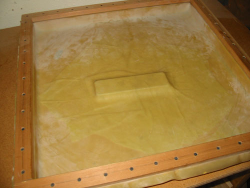

I then took my HHG syringe from the hot pot and applied a generous amount of glue to the bridge blank. I made no special effort to work extra fast nor did I heat the bridge blank. Then I placed the assembly in my vaccum frame, I use vacuum to clamp my bridges on so it was representative to me.
I left the assembly under pressure for 30 minutes and removed it form the vacuum press and set it aside.

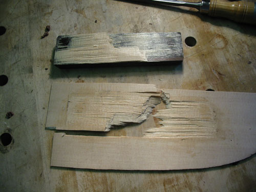

I then ripped it apart 12 hours later and this is what I got.

     If you look at the structural damage from the failure test one can see about 90% of the bond exceeded the wood strength. Obviously the sizing worked! If this is worse than a non-sized bond remains to be shown, but I doubt it.
    I would be very happy with that kind of strength. The explaination that the thinned HHG absorbs deeper is plausible if not very likely.
