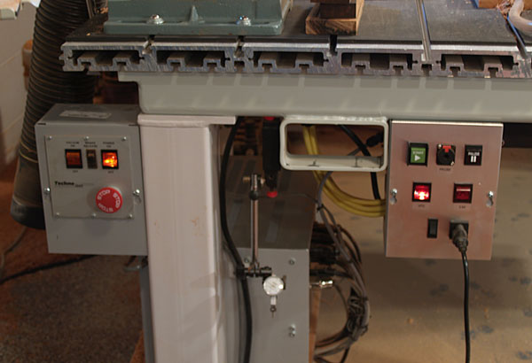

I re-wired their controller box last night, they had the engage switch and power light on the back where all the plugs where, not a good place. So I move the swtich and the light to the front panel where I could actually see them and make use of them. I also figured out how they wired the whole thing up, pretty simple overall...

My machine came with a control box, but I wanted more options so I added a second one. The options are Vak1 master power, servo brake release, controller power, E-stop, program start, probe jack (which if you look closely is a guitar jack), program pause, spindle control power, Vak2 master power, accessory power switch, and accessory power plug.

My plan right now is to add a router stop and start switch and hook it into the E-Stop button so that when I slam it down everything comes to a stop including the router. I'm going to make a little control panel for it like you did, just not sure where to put it yet. Also a good number of people using these have built sound proof boxes around them, not so sure about that just yet...
