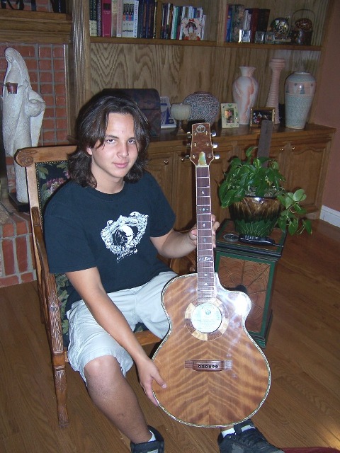

How about a Redwood top this one is curly but is readily available in straight grain and you can use pigment in the shellac seal coat to get as dark as you want. This one use only 50%amber 50%blonde flakes to get this color, and it is not all that expensive
MichaelP38952.5850347222
