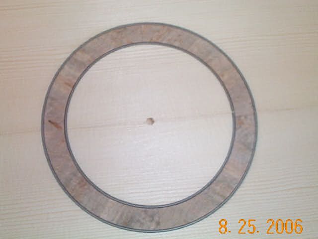

Well, things were going pretty well. I'm working along on my Adi top inlaying a maple burl rosette and got everything glued up this morning. Went to sand the sides to thickness and the little clip on my Delta 18/36 broke and the belt came flying off. I managed to get it working again by wrapping tape around the belt and going slowly. The sides are now sanded down nicely.

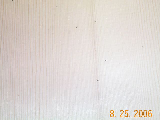

Then it happened, I was leveling off the top after finishing the rosette (almost finishing, the abalone hasn't been put in yet) and the belt broke and tore a gouge in the top. Man, I was soooo close to getting this ready for some braces. Here's some pics.
First, a pic of the almost completed 4 piece maple burl rosette. There was also to be an abalone ring in the center of the burl (glad it wasn't there already).
Here is a pic of the gouge that was left after the belt snapped.
And here is a shot of some imbedded pieces from the sanding belt. These are now all over the lower bout of the top.

Shawn, thanks for the suggestions. Unfortunately, the top is just about .110 thick and the gouge is at least .018 deep. I am not comfortable going with a .090 top on a 12 string, even though the adi is pretty stiff. And it might be even thinner than .090 by the time the entire gouge is sanded out.
This one is a custom build and I want the customer to get what he paid for. I'll hang this one on the wall as a reminder.

Well, I sandes the top down until the gouge was completely gone and it was only .075 thick. I think I'm gonna shelve this one and use it on a smaller guitar that I'm planning to build.
Thanks to everyone for all the great ideas for salvaging it. I already had a call in to Steve for a replacement before I even started this post. He says it'll be here next week. Great guy huh!
