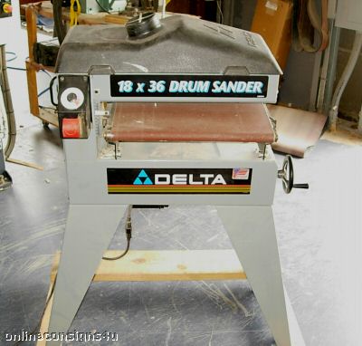

Check out this photo. I "think" it's of the model that is considered a little earlier than the 31-255X (meaning X5).
Anyway, this one is used and is relatively near me. Might could be had for a decent price. Some of the Delta reviews on Amazon indicate that the earlier models had some table gear issues that were aggravating. This supposedly was cleared up in later versions of the sander (again, the X5 model). The guy who has this is convinced it is the X5 model, and I don't think it is. (I'm willing to be wrong though)
Will one of you who had THIS model, get the model number off the machine for me? Also, have you had any issues with the table raising/lowering mechanism, or the table drive belt gears?
Thanks greatly. Buying a used tool scares me somewhat: no warranty, don't know how it's been treated, etc.

Looks like a mean machine Bill, Delta makes great tools so it should be good, pretty sure Todd Stock knows about them, maybe he'll chime in!

That's the same sander that ate my adi top yesterday. Kill it before it strikes again!
Seriously though, it has been a very good sander. As mentioned above there are some setup issues with it. On mine it was mainly getting the feed belt to track properly.
The thing that broke on mine was the small piece of spring steel that the belt clip is attached to. When it broke off the paper on the drum unraveled and made a mess of my top. Can't imagine why it broke, there is very little tension on it and it doesn't get constantly bent back and forth. Guess it just got old an tired, like me.
PostPosted: Fri Aug 25, 2006 3:42 am
I have the newer model. If you look in the archives you will find a bunch of pics of mine as it is/was for sale. I have had issues with the table not moving up and down as easily as I would like. But that is also due to the fact that I live in FLA. and everything rusts here in about a day. The performax is much much nicer...IMHO

I own the 31-250 and have had only minor issues with the belt
tracking and the table movement mechanisms, they were relatively
easily addressed by periodic maintenance and checkups. Early on I
dropped a belt, but that was due to operator error and not a flaw
with the machine itself.

I also have that sander, I have droped a belt before but now I alwas spray the drum with scotch 77 before applying the abrasive. Haven't dropped a belt since.
I don't believe it's an X5, but the X5 thing just seemed to me to be a marketing thing for Delta anyway. Although on this particular machine they may have fixed the issue with the clips, which would be good.
Other than that it's been a good sander, no table or tracking issues and it sands really flat. It has very good adjustments in this regard.Jim_W38954.7567013889

Check critically for sanding flatness - my Delta sanded .010" thinner in the
middle until I ground the platen down. Mine is about 7 years old and no
problems with tracking or lift mechanism other than the original tedious
setup.

This is the least popular tool in my shop, and the first one I will replace when I am feeling flush. The good news is that you can get it to do the job accurately. The bad news is that you have to nurse it along, taking tiny cuts and frequently changing the clogged sanding wrap. Sanding a guitar back about .006" at a pass is pretty tedious. Especially when it uses up two 80 grit wraps to do the job.
I have had no problem with table height adjustment or table flatness. I bought the machine used, and could see that the feed belt was misaligned and stretched out on one side. I aligned the new belt carefully and it has stayed aligned. However the grit on it wears down, and when that happens, your work stops feeding when it hits the rear pressure roller and snipes. To avoid this you have to be pushing on the work to help it feed through when it hits that rear roller.
Unfortunately, a serious thickness sander is a big and expensive item, and will need a new electrical circuit to power it, and maybe a new dust collector. In its class, the Delta is probably as good as the rest.

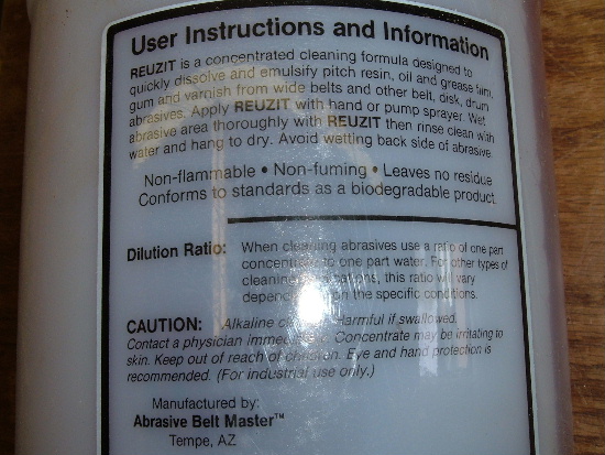

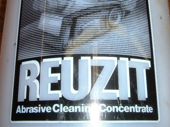

Howard, I don't avoid loading the paper
It's all about reducing heat in the wood. Dense, oily woods do not dissapate heat well and it can build even and especially with multiple light passes. Heat liqufies resins and oils and transfers it to the paper. Keeping the paper clean of build up and using both sides of the sander help. Let the wood cool if making several passes. Blowing dust off the roles will help if it in some way reduces heat build up, but It won't have any affect on heat in the wood and that's the problem area...not the rolls. Blowing dust off rolls will help kep them cleaner and therefore will aid that way. Whatever can be done to reduce heat in the wood is helpful.
Keep in mind that running a wide belt just means more belt to clean resin from...
I have the General, a 24" Grizley and a 25" Woodmaster so I have clean paper somewhere in the shop
I used to swaer by concentrated citrus cleaner for the paper, but this product is way better. I spray it on full strength and it melts the resin off..literally. Light brushing with a brass brush (not to hard or you remove grit) and wipe with a rag.

WOODCRAFT CARRY THIS PRODUCT?
PostPosted: Wed Aug 30, 2006 11:32 am
Posts: 2692
Where you buying that stuff, Larry? TIA.
Howard Klepper
http://www.klepperguitars.com
PostPosted: Wed Aug 30, 2006 12:05 pm
Posts: 600
I found it at a local contractor hardware store. Maverick Hardware here in Eugene, OR and they don't advertise, are in the back of a vacant lot behind some old buildings, but the contractors line up... It should turn up on a 'net search.
