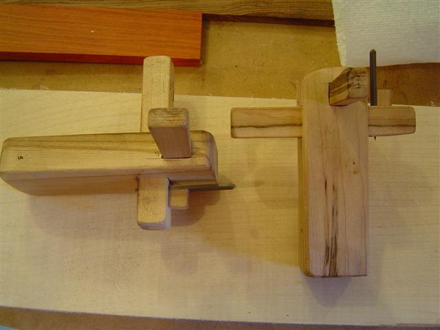

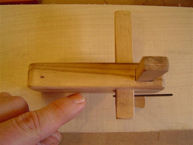

This is a picture of binding channel cutters based on what Romanillos uses. The one on the left is for cutting the channel on the sides and the one on the right is for cutting the channel on the top and back. These cutters you can easily make yourself. All you need is a marking knife blade and some scrap wood.
You will notice that the cutter for cutting the sides works like a scraper to score the side. Notice that the arm is not at a 90 degree angle to the blade. This compensates for the radius of the top and back.

Thanks, Robbie! Very interesting. I hadn't thought of using a scraping action on the sides...less chance of wandering.
