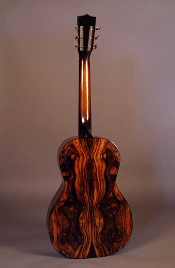

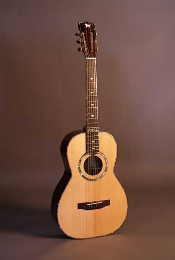

I have built 3 Mac Ebony Guitars and used jet black ebony for binding on all
of them. I like the look....picts attached

My choice for binding would be ebony, as suggested.
Andy, Thats a nice looking little guitar you have there.

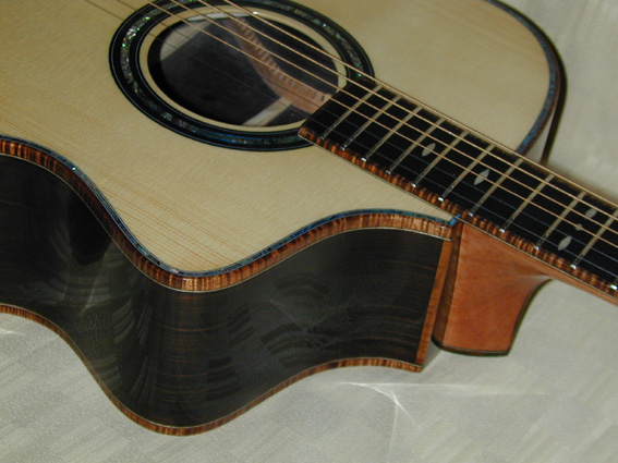

Here is what one of my students did last year - Adi top, dark maccassar sides, blk/maple/blk side purf, high flame koa binding, top purfed in paua and LMI fine blk/wh/blk. FB bound in koa and b/w/b too ... headstock as well, SWEEEEETT.
