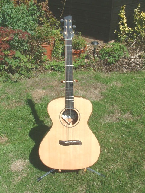

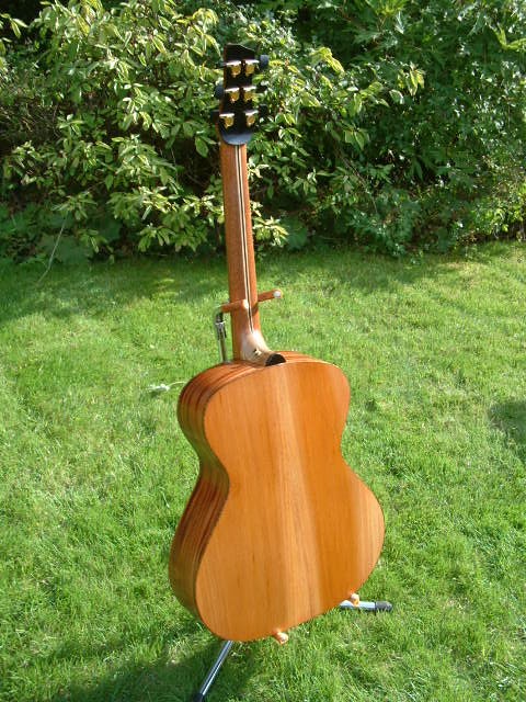

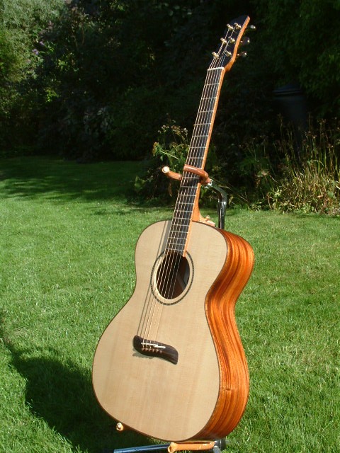

I was fascinated by Shane's post on harvesting Lutz so in the New Year I bought 2 tops from him. I'm a die-hard Euro spruce man but this wood excited me as it looked and felt very much like Euro spruce, had very good cross grain stifness and rang like a bell. I have finally got round to making instruments with them and here's the first.
It's my Daithi model which is somewhere between an OM and SJ I suppose. This is for a very talented young guitarist - Joe Bardwell - who plays amazing Irish rhythm guitar. His friend is an amazing young bhodran player and he has leart incredible right hand technique from him. I took the guitar for him to my annual week at Burwell and his technique is so hard that he was leaving pick marks under strings 3-5!! I have had to put on a clear pickguard covering all of the strings and not just the first 2 as I usually do. The guitar sounds amazing and the Lutz is a pretty close ringer for Euro spruce. It doesn't have quite the same initial complexity of tone as euro but it's pretty darn close and I will be interested to see how it opens up. Kudos to Shane - your wood is top notch
I'm hoping to do some recording of Joe's playing on the guitar when he picks it up next week.

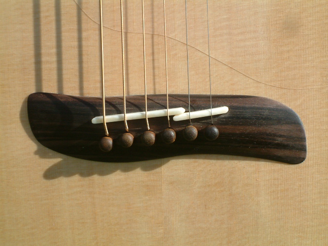

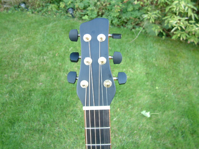

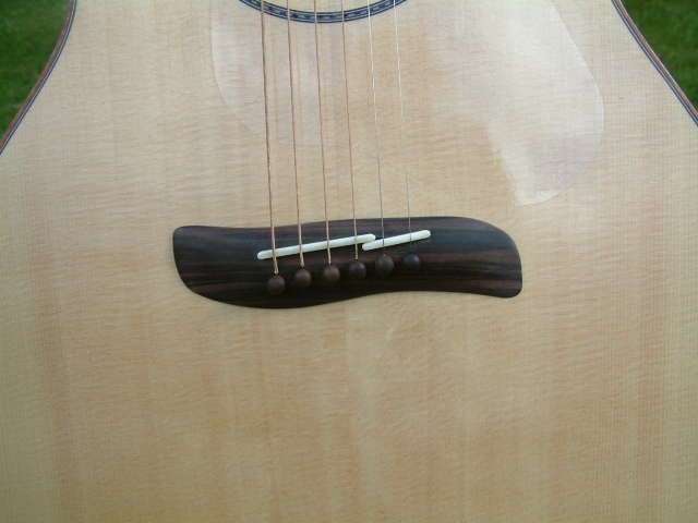

This guitar was my first venture into a pinned bridge (slotted bridge)and gave me freedom to invent a new shape. I also decided I would have a new headstock shape for my pinless models.

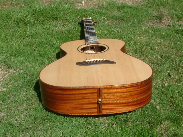

OK enough blab - here are the specs: Lutz/Cuban Mahogany with culy koa bindings. Neck is a 5 piece laminate of mahogany, sycamore, Old Rio Rosewood with ebony headstock veneer front and back. Ebony fingerboard bound with curly Koa. Macassar ebony bridge with Koa bridgepins. 655mm scale length. Gotoh tuners with ebony buttons.H and rubbed pre-catalysed lacquer on top, back, sides and headstock veneer; Tru-oil on neck.

I like the split saddle.
How do you find the popper position and angle for the 2 split parts?

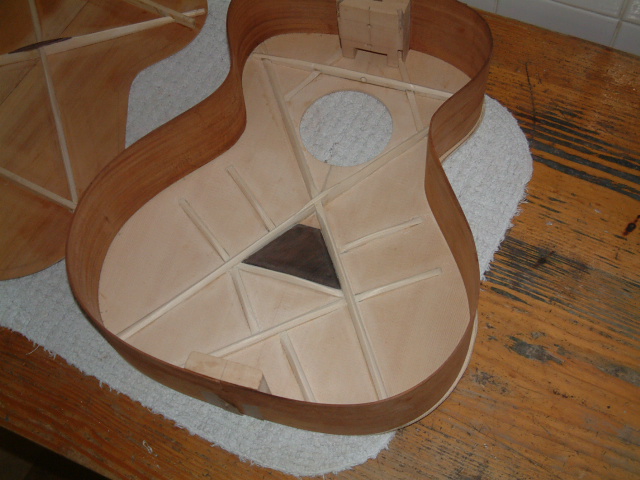

Dave just another stunning guitar, Cuban/lutz now I'm relly interested in how that sounds. Has it got your usual CF buttress braces? Like you I'm a die hard Euro spruce man but I do have one of Shanes Lutz tops (and of course some Cuban) and would love to hear your impression of the top.
Waht style is the bracing? I'm assuming it "parabolic" with an X back brace. Details please especially your sound impression compared to Euro.

I like the bridge design, just curious why did you go for a pinned bridge on this one ?

Alain - I have worked out the different angles through building all my guitars to date to give me spot on intonation along the centre of each saddle and use different "wedges" on the slotting jig I use depending on the model. On this guitar with 655mm scale length, the string lengths from nut to centre of saddle measure 657mm, 659mm, 657mm, 659mm, 661mm and 662mm respectively. This works well for dropped tunings such as DADGAD and also with the 6th string dropped down to C, using lights (0.012"-0.053")

You'll love working with the Lutz. It's not as fussy and easily dented as Euro but in a lot of respects you feel you are using Euro. Great sound as well. My initial impressions are about 95% euro on first stringing. Euro has slightly more complexity and subleties, but the Lutz works fabulously with Cuban. It works even more fabulously on the guitar-cittern I have finished and will post about later this week. I will be doing recording with both and will post sound samlples. Yes - parabolic on both top and back with free floating neck and cf buttress braces (the guitar cittern also has an adjustable neck). I really like the X braced backs as they get the back really working with the top in a positive way. You can feel it in your stomach as you play. I didn't take too many pics of this one but here's the top and back bracing:

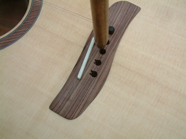

Russell,
The guitar cittern has 10 strings and 230lb tension and I didn't like to trust a pinless bridge. So I did a pinned with 5 holes - 2 strings per hole. I liked the bridge shape and thought it was about time I tried one on a 6 string so did this one.

I like the non-Martin lower bout bracing!It's time for makers to figure out why there is the martin buldge behind the bridge !
Also a straight across brace at the back of the bridge helps with top responce to input!It moves up & down with out the looseness of the martin design because of the stiff little brace behind the string -plate holding the top stiff in that area!
