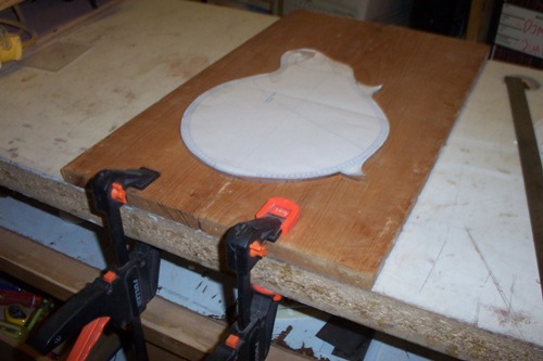

Hi folks, i've been a slacker lately, especially regarding progress pics so here they are, i've been making some jigs and templates for the mandolins that i'll be building, i thought i'd share at least what i did so far on this, i'm new to mando building as well.
I bought Siminoff's book and also the Macrostie's plan from LMI for Loar's F5, it's such a different game somehow, everything is so small but i feel i can do it!

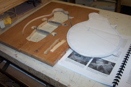

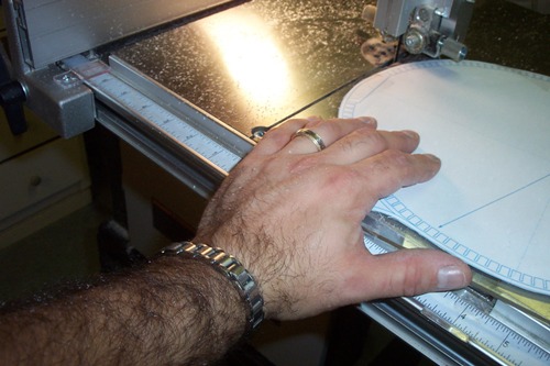

Making a plastic template for the body mold, cutting it on the bandsaw

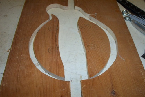

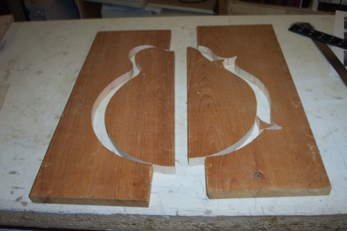

Making of the body mold
Preparing for the spreaders

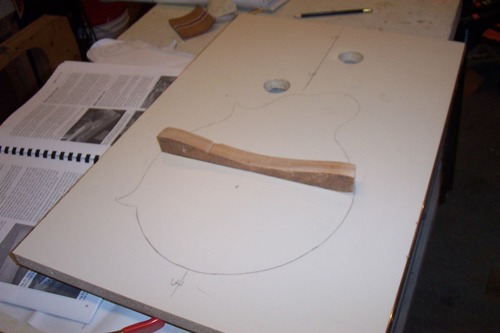

This jig is for when you glue the neck to the body, the holes in the board are there to allow the clamps to reach from under the board
My neck template, geez it's small!

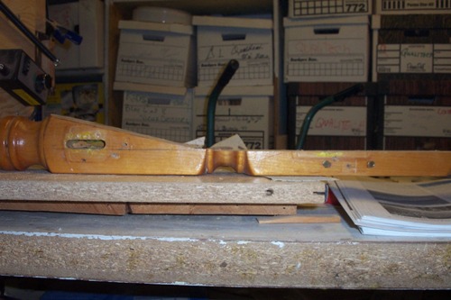

This one is a piece of recycled furniture turned into a neck support for carving the neck, it will be held in a vise and the neck will be clamped to it.

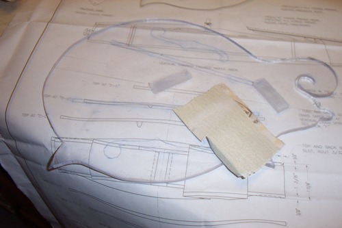

As we have communicated about earlier, I would ditch the Siminoff template and use your McRostie plan as a reference instead, meaning you will have to shim / sand your your current mold here and there.
One more thing I notice: Your template is missing the "button", the part where the back extends over the neck heel. Make sure you remember to leave enough wood for that part as it is an important structural detail. Some of us have forgotten to do so because our templates at the time were missing this detail .

Here's an easy way to make some pretty tough and long lasting templates quickly (I have not seen the method mentioned anywhere else, but it works so I'm sure others are doing it too!). Make several copies of the part of your plan you want to make a template from. If you don't have access to a very good copy machine that can make copies WITHOUT DISTORTION have a copy made at a place that makes copies for architects, they will usually have pretty good machines. Check for accuracy by holding the original and the copy over each other against a window or light table. When satisfied, cut out the part to be made into a template, glue it to some 1 mm, stiff cardboard (we call it "book cardboard" over here, don't know the English term, much less the French! but it is grey and dense). Very carefully cut the template with a sharp utility knife (and a straightedge where possible), this should not be hard as the cardboard is quite thin, but make several light passes just the same. Once the template is cut out, spread some thin CA glue along the edges. This will make the edges much tougher, and you can sand or file them until they are just right without the cardboard getting fuzzy or disintegrating. This will also make the edges smooth and give you more accurate pencil lines when you trace from them, and they will wear pretty well.
I do use Siminoff's pinned, straight mortise neck joint, I believe it can be equally good as, if not better than the dovetail joint that McRostie shows, if executed well. Of course, I've never made a dovetail joint on a F5 so what do I know, but there is certainly more wood contact with the straight, pinned joint, and it is pretty easy and fool proof to do. Oh, and remember to cut the truss rod slot BEFORE you taper the neck, NOT as Siminoff shows it! I also recommend using a router table to cut the binding channel (we can get into all of that later).
Oh, and the "button" is not a separate piece, it is the equivalent of the heel cap on a guitar, only on the F5 (like the violins) it is just an extension of the back plate. As I said, it is an important structural detail, and easy to miss when cutting out the back plate unless you include it on your body template...

Thank you very much again Arnt, just what i needed, i went back to the shop for a quick glance at Macrostie's plan and now know what you were talking about for the "button", ok, no more excuses on my part then, i'll scrap that body mold and make another one that will be sturdier with Macrostie's plan. I just saved your post, i will rebuild the body mold during the coming week end and thanks for the templates and copy tips!
I'll be also doing the straight mortise joint, i'm more comfortable with them than the dovetails.
As said above, will redo the back template including the button as an important structural detail that i sure had missed, i'm sure glad i PMed you for advice brother! Will keep you posted on all the changes to come.

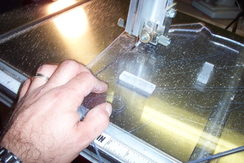

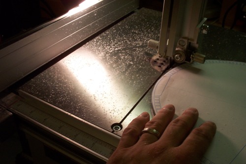

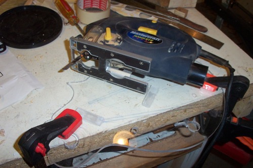

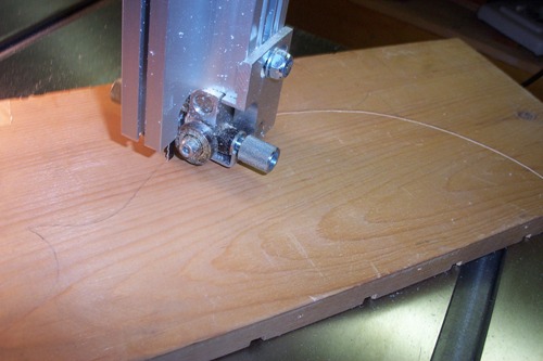

Well, i listened to Arnt's great advice and redone the body template and added the button that was missing, i made it wit some plexiglass i scrounged from an old aquarium lid Thanks Arnt
here we go again on the bandsaw!
A bit of sanding around the edges

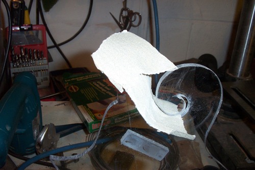

I must be getting old, i used these for the first time, it was really helpful when working around the scroll area

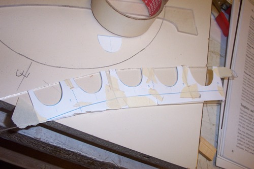

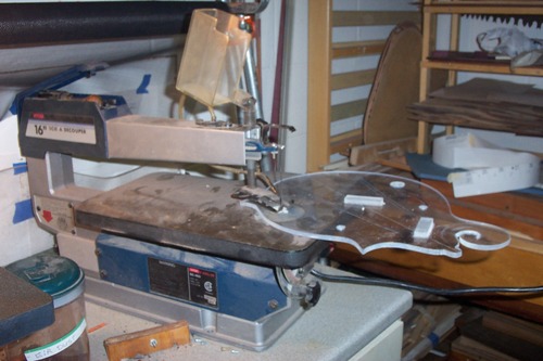

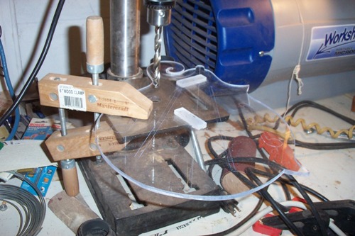

using the drill press to pierce the f-hole to be able to locate them properly on a future top
Tried to make my way inside the F hole with the scrollsaw but it heated the plexiglass to much making it melt and close back,
Had to use the jigsaw to finish it!
AAH, the learning curve!
