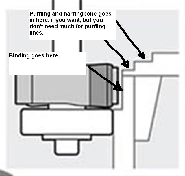

I think the Stew Mac site has a good picture of the binding ledge, actually so does the Cumpiano book.
Here is a doctored up picture
As far as the chamfer goes, it is on the inside edge of the binding strip, it never gets seen. It's there so that the inside edge does not interfer with seating the binding, this will help get a tighter fit.
The next question is, what are you using to cut the groove/rabbit (same thing here)?
You always want this "groove" to be straight, parallel with the sides, not registering off the top or back as usually these are domed to some radius.
