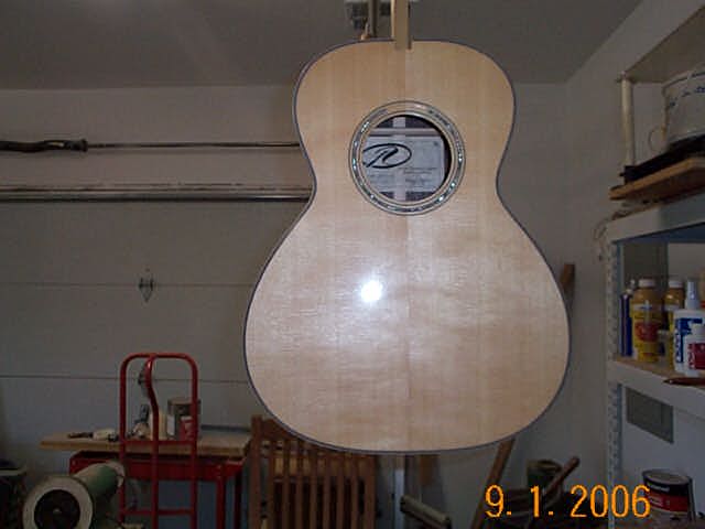

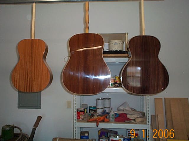

Carlton, here are a couple of pics of the L-00 body. The first pic shows three guitars. A small body guitar, a dred and the L-00 is on the right.
The second pic shows the L-00 alone from a front view.
Hesh, glad you got the plans! I think you'll like this one a lot!
PostPosted: Thu Aug 31, 2006 7:23 am
I forgot to mention, the L-00 has B/S from the opportunity grade EIR from Allied. The top is Lutz from Shane. This is not Shane's best grade either.
