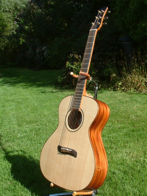

As promised here are some sound clips of the Lutz/Cuban Mahogany guitar I posted on a few days back, topped with one of Shane's great pieces of wood:
The pieces are ones taught to me at Burwell by Ed Boyd and Brian Finnegan of the group Flook. I have recorded them on my Fostex FD4 using an AKG microphone with no EQ adjustments or effects added. Both pieces are in DADGAD and are pretty representitive of the guitar's acoustic sound. The strings are D'Addario EJ16's (0.012"-0.053") about a week old.
The first piece is "Famous Last Words" written by Donald Shaw of Cappercaille and recorded by Mike McGoldrick on his CD Wired. It is a great piece in 7/8 time and pushes my naff flatpicking to it's limit - and sometimes as you will hear I fall of The lead is flatpicked with a Dunlop nylon 0.73mm pick and the accompaniment is picked with thumb and fingers:

I was just wondering, are there any special thing to take into consideration when building a guitar to play in open tunings, such as the DADGAD tuning mentioned?Dave Rector38961.6379050926

Dave, my answer about a DADGad guitar is to build with parabolic top and X back braces, to get the attack. Then dedicate the guitar to DADGad and similar tunings by using a balanced set of strings weighted accordingly.

Dave R - DADGAD and other open tunings usually involve tuning down from standard and have open strings that sympathetically ring and support what you are playing. Tuning down I find makes a guitar more alive and responsive but you have generally slacker strings. So I am looking for a guitar with great sustain and balance across the strings. I do this by using a big arch in my tops (13' radius braces) and keeping the top thicker in the middle (to help with mids and trebles) and feathered behind and at the sides of the bridge. I use a very narrow X brace angle and have the soundhole large but shifted forwards. I prefer parabolic bracing but the top needs to be ringing and sustaining as much as possible everywhere. Lightly braced upper bout with free floating fingerboard extension (only attached by the 2 neck bolts) adds to harmonic richness. I personally deal with the string tension by using longer scale lengths - 25 3/4" is my favourite. I play over a dozen "altered" tunings and use a set of EJ16's and retune for all of these, although I'd probably tell my customers that they need a guitar dedicated to each tuning
Bob - Cuban is one of the hardest of the mahoganies so you get more of a Rosewood tinge to it. It gives a sound that I really like.
