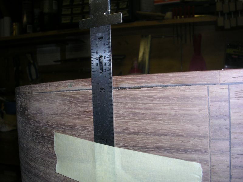

Exhibit A
Tell me I'm not the only one who gets these...

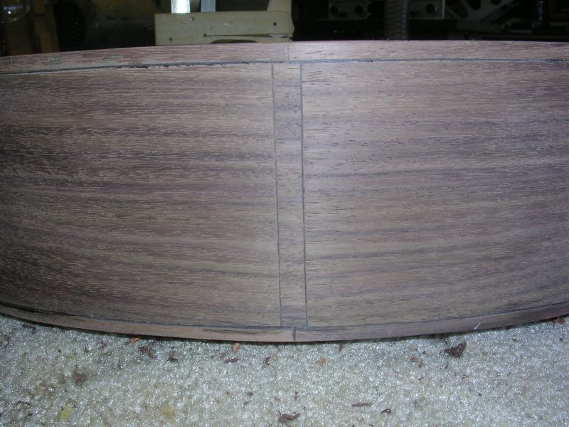

Exibit B
Yeah I know this is a big one. Not sure what happened here...

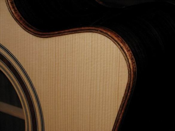

Here's a little preview of the cedar topped Hauser I'm working on...

For the gaps on the back and sides I would use CA and sanding dust from the B/S. It is pretty hard to hide the gaps on a top, but the best way I've found is to cut little slivers of matching wood to use for the fill.
Wish I could tell you a better way, I just don't know of any.
PostPosted: Fri Sep 01, 2006 11:55 pm
On rosewood, just take a thin drip of superglue on the wood right by the crack. Then while it is wet sand over it in long strokes. Within a few strokes it will fill the gap completely and the rest of the glue will "disappear"
You can't fill huge voids like this, but tiny cracks work ok. It is a pretty good color match, but you can kind of see the fix if you are looking for it.
This doesn't work as well on lighter woods.

For EIR, I sand some scrap pieces on my spindle sander (make sure the deck of the sander is clean)and then put the EIR dust in a medicine bottle for future use. When needed, I mix a little with epoxy and put it in the gap. After it is sanded flush and the finish is put on, its awful hard to find.
PostPosted: Sat Sep 02, 2006 12:58 am
The CA/saw dust works very well for EIR and darker woods. Doesn't work at all for lighter colored woods.   Well, I mean it will fill the crack, but the repair will be visible because it is like wetting end-grain.

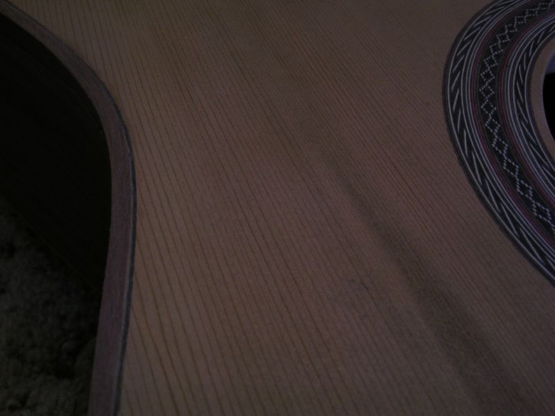

That looks like walnut. For lighter colored woods I try to take slivers of the same wood and just fill the crack with them. I use HHG. If you're patient and take the time to make the sliver an exact match, the repair will look like grain marks.
For the tops, the best I've found was using slivers of the same material. As per Paul Woolson's excellent advice, use a sliver that was cut across the grain (or in any direction) so that you can match the grain lines exactly.

As people have said, dust and epoxy/CA will fill small gaps on back & sids (with dark woods) extremely well.
But for me, gaps on the top can never be filled to look perfect. (Although I need to try Paul's/Alain's suggestion on slivers; it sounds like a great idea.)
Gaps on the sides under the purfling (like your Exhibit B) can be filled, but the purfling will be an uneven distance from the edge, and will look a little off upon close inspection.

Just a suggestion - why not cut it off and make it right? Those gaps imply a technique issue. Perhaps you cold talk about how to avoid the gaps.
How do you rout the ledges and prepare for adding the binding? Is you tool parallel to the sides or perpendicular to the top? Do you use binding tape?
If you are in So Cal, you could bring that box to my shop and use my binding jig.

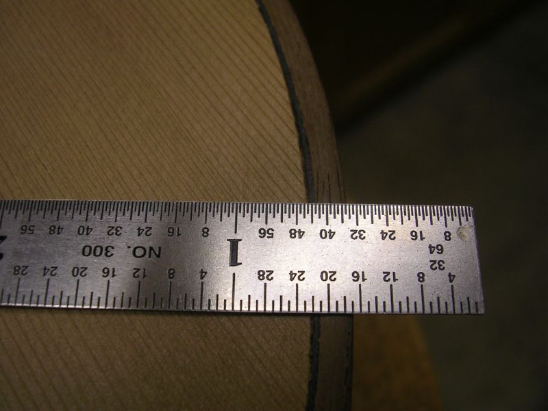

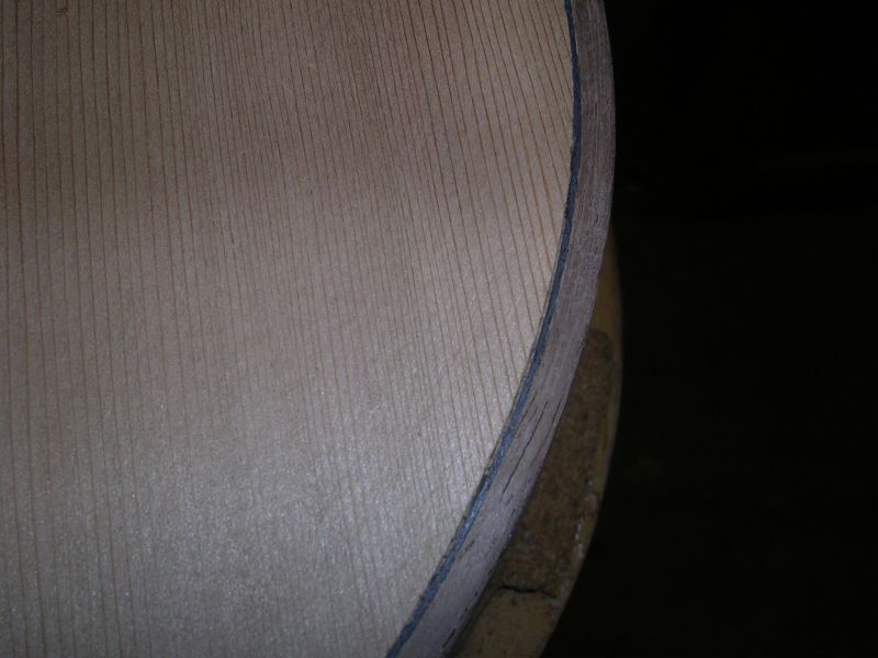

Thanx for all the answers guys. FYI I just went out and measured the "huge"gap in exhibit B. It is 3/64"! I know it looks a lot bigger but I must have had just the right camera angle to look right down inside when the flash went off...
So let's look again..
Exhibit B redux
Exhibit A redux
SteveS
Thnx for the offer. I'm probably 4 hours from you at best so... For the cost of gas and time involved I could really probably build one. Thnx again for the offer.
I really need to build a jig. This has been a continual problem that I really thought I could beat. I currently use a handheld router with a convex base.
So just to be clear, Nobody else is getting these type of gaps? Is that correct?
If not, did going to one of the binding jigs available end the occurance of such gaps, or am I just being ham fisted in my building?RCoates38962.6882638889

It is difficult to see from the pictures but is the problem in the cutting of the ledge or is it that the purfling/binding is not staying put while gluing/clamping?
On the top it is easier to get a gap because of the gluing/clamping not being tight all around...on the sides it may or may not be the cut.
How are you gluing and clamping the purfling and bindings onto the guitar.
It is not that I have not had gaps before but I agree with Kelby, I take it off and start again. I trust my ability to cut, glue and clamp than my ability to fill without detection.
Even if I am going to use a router to cut the purfling/binding ledge I will still use a gramil as it eliminates the chance of chipout which looks far worse than a repaired gap. If the guitar is a special one for a particular customer I will still cut it all by hand instead of the small time savings of a router.

I've had both problems in the past and this time was careful to not let the binding ride up over the top/back. In fact, I just went and measured the bindings and the problem you see here is the cut of the rebate. Again I need to build a binding cutting jig. I suppose there's no getting around it.
I did use a gramil on the top, but just lightly scored it. Next time, deeper.

On the sides an back gap problems I sand up the area and get some dust close to the surface I am going to work on, carfully apply the LMI FCA glue in the gap (I use a fine tip 1 oz squeeze bottle) and then with a sanding block and 220 sandpaper I sand the area around it and slowly move the dust created over the gap. I have tried the dust from scrap premixed and I had to much coloration difference. On top gaps the Sloan tool available on StewMac is nice, but I just cut a wedge shaped sliver out of the top scrap using an exacto knife. It takes some time an patience to get a nice matching tight fit but once you do then I use LMI White glue and set it in place. After it has dried I use this flat narrow razor blade tool to trim to level, hit with some sandpaper and if you match the grain pattern and color it really blends in nice.

Ronn on the side the gap is very consistant in your picture. It looks like to me anyway that the binding and purfling did not seat on your bottom ledge on one side of the body. This can sometimes be caused by the binding ridding up during glue-up on a radius left in the rabbit by a worn router bit. This can be over come by three means. The first is to over cut the bottom corner of the rabbit with a chisel so that you remove the radius left by the bit. The second is to put a chamfer on the bottom inside edge of the binding-purfling larger than the radius. Third is to get a new bit but it too will eventually wear a radius at the bottom edge of the flute So I chamfer the inside-bottom edges of my bindings.
Also what ever tie down method you are using need to both pull down and pull in the bindingsMichaelP38965.7138657407

I have had good results at disguising the ones on the top by shooting a few coats of lacquer then drop filling them just prior to the first level sanding. I've used both CA and Lacquer for drop filling with equal results. CA is quicker though. After drop filling I scrape the fills using the razor blade and tape method then wet sand. This only works for the small ones anything of any size, and I would reroute and replace the binding with new.
