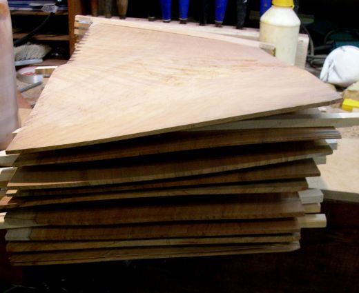

I thought that it would be prudent and timely to bring to your attention some guidelines that I have found from experience will help those who have purchased some Tasmanian Blackwood as part of the group buy.
If you are anticipating a billet(s)delivery from Shane then you would do well to read my comments that I posted when the Tasmanian Blackwood was initially offered. http://www.luthiersforum.com/forum/forum_posts.asp?TID=5874& KW=blackwood&PN=0&TPN=2#forumTop

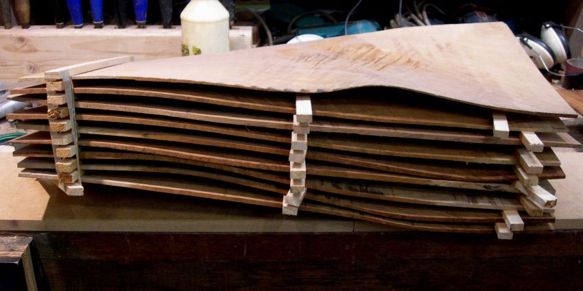

I hope that you will never end up with sets like these but this is what can happen when the blackwood has been exposed to one or more of the following conditions.
1. Resawn unseasoned and left without sufficient strapping and stickering.
2. Exposed to a dramatic moisture reduction with or without stickering.
Blackwood from my experience in the resawing process benefits from some initial racking out before being resawn into sets. There is also some tension present in most boards with the highly figured material being most prone to movement if not restrained. Following the seasoning process Blackwood is very stable and a joy to work.

Take heed brother OLFers take heed.
I have watched in horror with my own eyes as veneers sliced from this 15" deep board of unseasoned blackwood cupped and buckle dramatically as they sliced from the billet.
Not only did the veneers themselves move like a worms as they came from the new blade, also to did the 1 1/4" thick billet cup against the fence with such force that it was beyond mere mortal to control...
Beauty does cometh at a price my friends. Beware he who should be tempted to claim her too early less she fly from thy hands to be lost forever.
