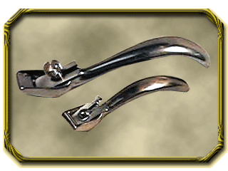

I've also had great service from some tools made and sold by St. James Bay Tool Co.
On top is an "Instrument Maker's Carving Plane".
Below it is the little "Bow Maker's Shave".
These are great tools, and not very expensive.
www.stjamesbaytoolco.com

The "Instrument Maker's Carving Plane" reminds me of a similar tool that a ran across some time ago. The difference is that the tool cut on the pull stroke. Should have bought it at the time as I now can't remember who has it. Can anyone help me out here?
