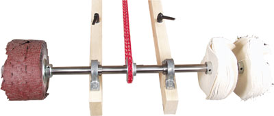

the Klingspor arbor is a great way to go. It gives plenty of room end-to-
end, has a more substantial arbor (1" I think), easily takes 14" buffs
doubled or tripled, and doesn't take very much to set up. Any 1/2 hp
motor will do. I have never experienced any significant vibrational issues.
I haven't used it, but the S-M arbor looks very narrow to me and won't
allow you to use larger diameter buffs, which give you a lot more
clearance when buffing. I think it would be so easy to bump a guitar
against the center section with the S-M unit while moving the guitar
around. The Klingspor is cheaper too.
Craig S.

Posts: 334
Bob,
you can find it on their web site, but it's hard to find. The part number is
CL34000 and is called a 32" MANDREL W/ 1" SHAFT KIT. It looks like
this:
Craig S.
