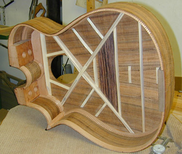

BTW Tony MY next build (now using walnut for the neck as well as the back & sides) will be a 6/12 double, so I'll be spending a LOAD of time looking at this pic.......

You may want to stare at this one for a while then too ...

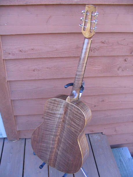

Here's one of mine. That's walnut for the back, sides, and neck.
