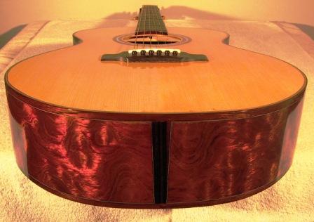

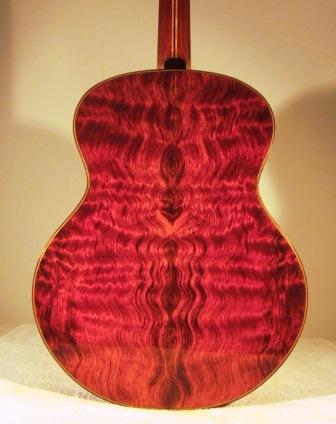

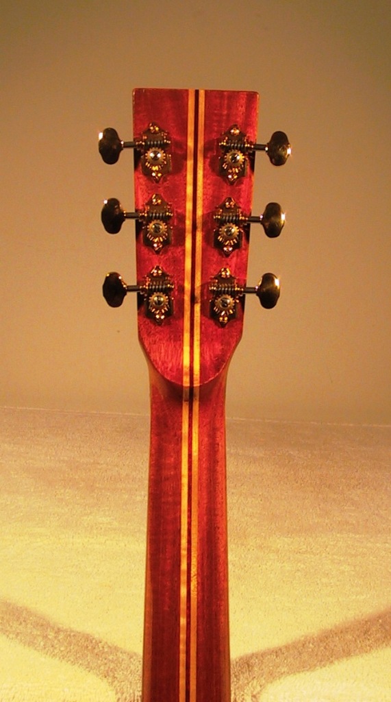

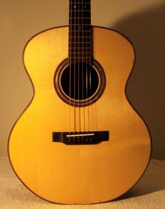

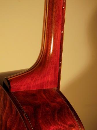

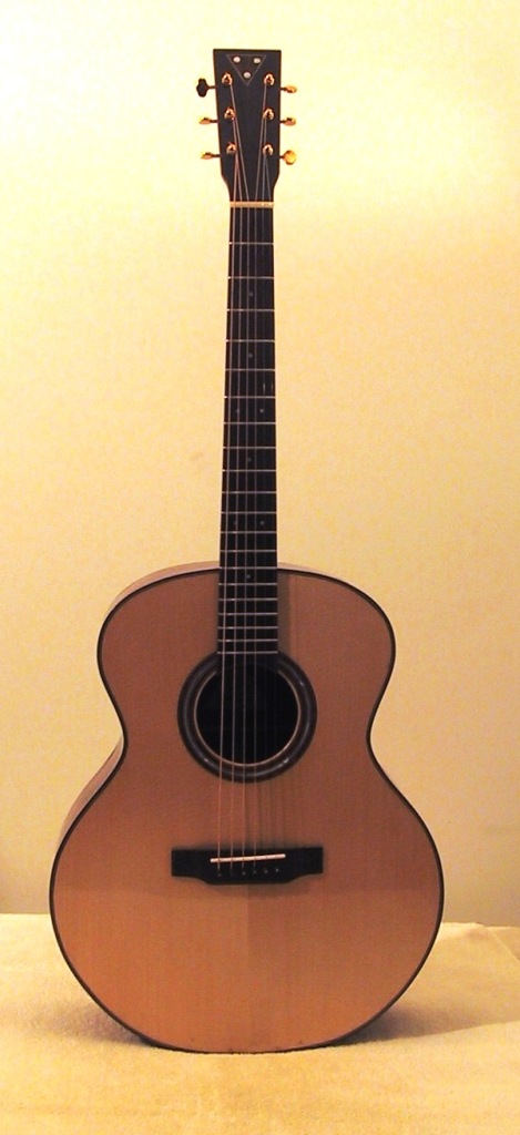

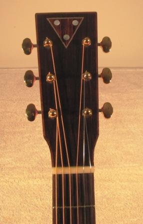

I only post a completed guitar once a year so here's the latest (#5). This one is for me since I ran out of sons and brothers to build for.
Since I name all of my guitars, this one was christened "Tippie" in honor of our John Hall who gave me the vampire bite 4 years ago and helped me in so many ways. It's an OLF-SJ made from Michael P's great plans.
Specs include:
Top...Carpathian Spruce...Zootman
B&S...Waterfall Bubinga...Zootman
Braces...Adi...AdirondackSpruce.com
Binding...BRW...Colonial
Bridge...BRW...Zootman
Headplate...BRW...Zootman
Butt Wedge & Heel Cap...BRW
Neck...Mahogany w/Maple, Bloodwood, Maple laminations
FB...BRW
Tuners...Waverly Gold
Finish...French Polish (Thanks, Michael P. & Alain)

JJ!!! Wow... That is superb! Top drawer! I couldn't wait to see that gorgeous Bubinga under finish...
I especially like the third pic, where she's lying on her back... those side look like shimmering liquid. I'll bet the photos don't do it justice either.
Very well done, my friend. Your craftsmanship is top drawer as well.   A fantastic instrument in all respects.

   Man is it 4 years allready ? Thanks for the honor of having a box named after me . Your skills are outstanding and the guitar is beautiful.I would love to play that one . However you should have made the headplate with a few bald spots and maybe expand the waiste a bit LOL.
Oh yeah maybe add a few winkles in the finish and some gray steaks .

Man that Bubinga pops under the French Polish!
Awesome job JJ!
PostPosted: Sun Sep 03, 2006 11:54 pm
Yessiree .. that sure did POP under a finish (always amazes me still, students too, what the top coat does) ... looking mighty fine JJ.

great job JJ!!!! Really beautiful shape., and clean lines to boot.

Alain...the FP was a great first experience. I know I used a lot more elbow grease than I will on the next one. Fortunatly, this process allows instant correction from technique errors. In general, the gloss is OK but I believe I could have done a better job in surface prep and pore filling on the back. I will end up sanding the back down to bare wood, re-pore filling and redoing the FP. I want the surface sheen to be more like that on the sides and top. This wood must be presented with my best effort!

Lance...The tip you gave me in Ft. Erie was great. I sanded the perimeter until the sweet spot moved. The sound is more mature than I expected, so I suppose it may have less opening up to do. Time will tell. Right now it's loud and sustains well. The tone is balanced and sweet. I'll bring it to the next MGL meeting.
Tony...Your recommendation on the neck tenon and cheek worked like a charm...the flossing was problem free and I got a very tight fit...thanks!
John Mayes...After watching your DVD, this was the first guitar that I actually voiced. I tapped and chiseled until I actually got a tone that shimmered. Kudos on the Voicing DVD...my favorite of the whole series. BTW...I never did find the secret passage of you buffooning!

One really weird thing I noticed on this finish/wood combination is that it looks totally different in different light. In fluorescent lighting, the wood looks more brown and somewhat shallow in depth. In incandescant lighting the surface becomes golden-red, somewhat iridescent, 3 dimensional and deep enough to dive into! I'm planning to take more pics in outdoor lighting and see what that shows. I can't say that I've ever seen this before on other woods. Any thoughts?
