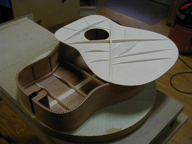

After reading Shane's post on resawing Lutz tops, I thought I would post a picture of one of his tops (from Bob C) I just braced up. I decided to go with low (half inch at intersection) X-brace instead of scalloped and if it sounds half as good as it taps it will be a great guitar. These are really lively tops, can't wait to hear the results. Thanks for the great work Shane.......

Paul, nice looking work there. I bet you could give Lance a good showing in the cleanest box competition!
PostPosted: Tue Sep 05, 2006 1:35 pm
Paul, that IS some fine looking wood. But I'm with Joe, the workmanship is the impressive element in your photo!

Paul,
That sure is fine looking work! The insides look better that my outsides. What kind of finish will you use?
I too like the lightly braced top. With a full depth dread body is should be really something!

Very nice looking top Paul, excellant job!I like your bracing too.

Hey Paul,
Seeing this wood used in instruments like that really hits home for me! That is indeed Fine Fine work! I sure hope that the top honours your fine craftsmenship.

cool dude... tell us about your brace behind your bridge plate! Really nice clean work..

Paul thst looks fantastic. I know that Lutz top will compliment your fine workmanship.

Looks really good the workmanship , as others have said, is impressive. I really like the light non-scalloped bracing should give a very responsive top.

Looks great Paul. What is the back & side material?Nice looking guitar... Very clean as others have said.

Thanks for the kind words. I'm excited about this wood, and will definitly be getting more.
The back and sides are Honduras Mahogany
The brace behind the maple bridge plate is a bent lamination of three pieces of 1/16" spruce.
I usually use a double X brace, but stick with the traditional pattern on Dreds.
                        Paul

This axe will be awesome Paul, i know you will just love the sound that will come out of there!

Very fine work, Paul! Oh, and nice top wood. I'm building with Lutz right now too.

Wow, that's one clean box. Love the parabolic braces. Very, very nice looking guitar.

Really nice, Paul! It can't help but sound great!
