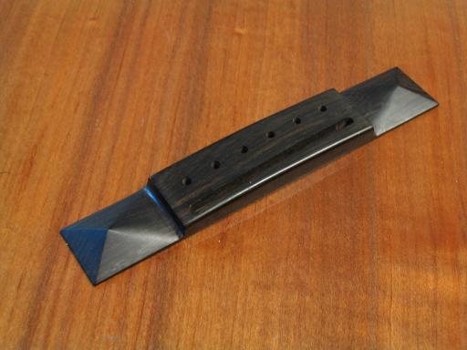

I recently made a pyramid bridge from african blackwood, rings like rosewood and looks a lot like ebony. Weighs 28g.
PaulB38965.9963657407

nice, Paul.

[QUOTE=Howard Klepper] nice, Paul.[/QUOTE]
Thanks Howard.
Frank Ford has to get a lot of the credit tho, he's got a pretty good demonstration on how to make them over at frets.com.

Very cool bridge Paul !
