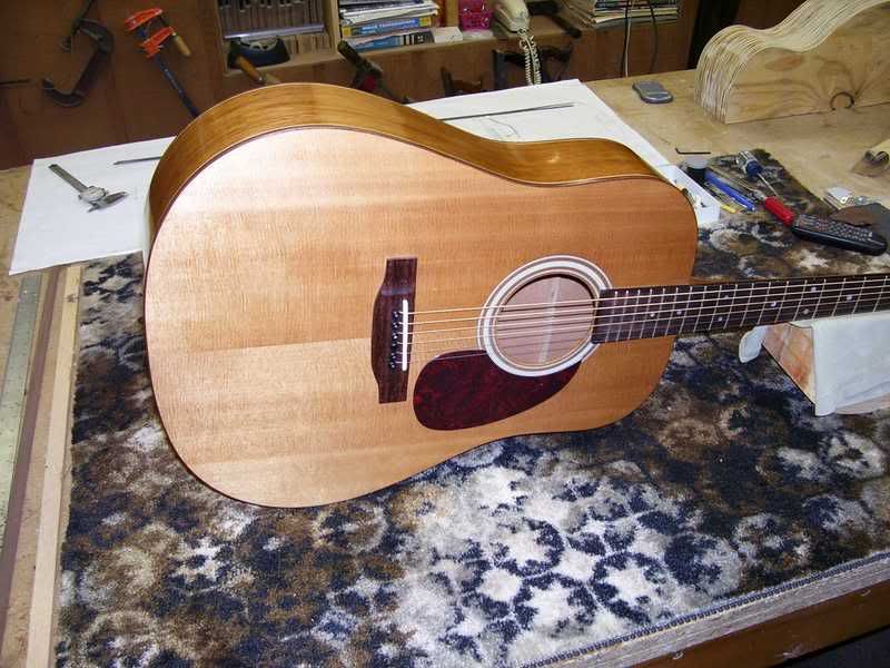

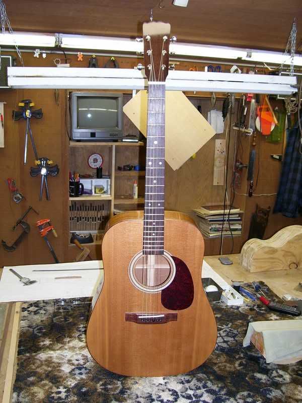

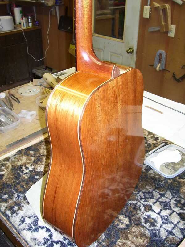

I've been poking around here long enough. Time for show and tell. I haven't posted a picture yet, but here goes.
This is a Martin kit I bought 15 years ago. Finally finished it last December.
FP finish and my own maple-walnut bindings.

Fantastic work, Kirt. I like how nicely the purfling lines up going round the heel. Nice FP, too!!!

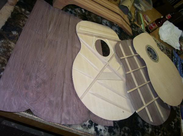

Here's what I'm working on now. This time from scratch. 4 piece walnut backs, lutz tops, mahogany/maple necks. This is my own pattern, and I'm doing 2 at the same time. I hope to do better than 15 years on these.

Very nice work over all.
I love the dark top on that guitar! Looks like some old sitka. For a second I thought it was an all-mahogany guitar. Very nice.

Yep, that's about 15 year old sitka. It spent about 5 years in a closet as a box. I changed jobs 3 times, moved once, put a kid through college. You know, life in general kinda held me up. At least that's my excuse. I got tired of everybody saying "hey did you ever finish that guitar?" Time to get serious, I've got full blown TAS and WAS now.

Well, it does have a few warts, (I know, compound-W), but overall I'm quite happy. I've been playing the heck out of it.
I started out with extra light strings, but now I have lights on it and it sounds much better. I could have thinned the top more, I think it ended up at about .120".
The change to heavier strings also raised my action a little. I adjusted the truss rod, but I need a little more, so I'm going to thin the bridge some and bring the saddle down. The bridge is just shy of 3/8" so I should be able to bring it down some. I'm thinking I can go down to 5/16" if need be, since the top is so thick. It's had about 9 months to settle in so hopefully it should be safe to tweak in some more.
One of the biggest bo-bo's was to use Stewmac paste pore filler before I sealed the guitar. It muddied up my maple purfling, you can't really see it in these photos. I ended up pumice filling everything after that.

Great looking guitar Kirt! I'll echo the cudos for the purfling line crossing over the heal... Very nice!
