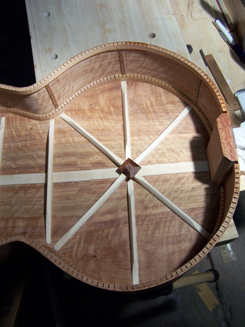

PostPosted: Fri Sep 08, 2006 4:59 am
As Dave just stated, it makes the back more cntrolable in it respoce I use a star shape on SJs and Dreadnaughts(a 90 deg X with added laterial fingers) this also suports the dome shape better. It als allows me to use shallower and thinner braces there by reducing mass.

PostPosted: Sun Sep 10, 2006 11:55 pm
Yep just a min and I will find one
PostPosted: Mon Sep 11, 2006 12:02 am
Here is your picture. This is an SJ
MichaelP38971.3781481481

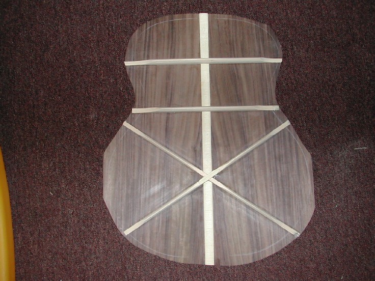

PostPosted: Mon Sep 11, 2006 8:50 am
Posts: 975
First name: Tracy
Last Name: Leveque
State: CO
J.,
Here's a pic of mine(I know, the X is off). This was my 2nd guitar, and I really love the sound of it. I love X braced backs, I think they look cool and sound better. To my ear, at least.
PostPosted: Mon Sep 11, 2006 11:46 am
Posts: 3933
That's about the layout I use. I generally end up with the X tall in the middle and tapered off, and the waist bar quite small, but that's just what seems to work for me. The X angle is probably important, but I haven't figured out yet how to get it 'right' the first time.
