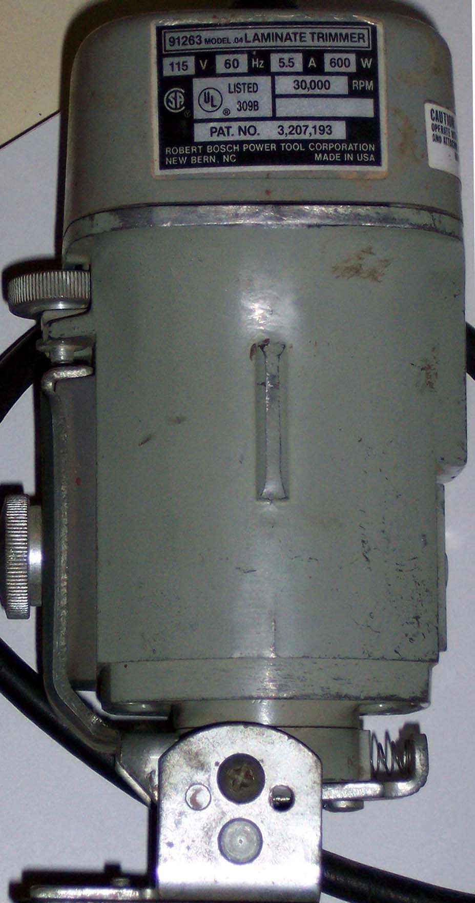

Michael, I contacted Bosch and was informated that they haven't dealt with Stanley products for over 20 years and they do not have information or parts for my router. That made me tilt my head a bit. Stanley is no where on the router. Bosch is the only name I found.
It is really a shame. Its solidly built, metal body, works beautifully. Oh well. I'll figure out something to so with it I guess.Aoibeann38967.2977430556
PostPosted: Wed Sep 06, 2006 10:31 pm
lillian, have you lost the collet, or is it worn out, or what. is it the little stanley with the domed top on the cylinder? i have seen them come up on ebay from time to time.

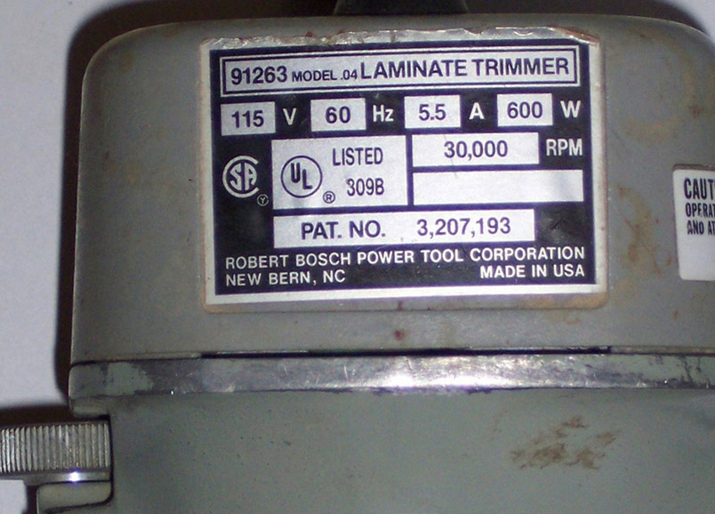

Michael, I bought this one off Ebay. Didn't look to see if there was a collet, just assume there was 'cuz the seller said everything was there, great working condition, money back, etc. Plugged it in to check that it did work and then pack it away to move. Since a picture is worth a thousand words....
Dang! Photoshop said that they were only an inch by a little more than an inch. They're huge! I have to remember that.Aoibeann38968.0015625
