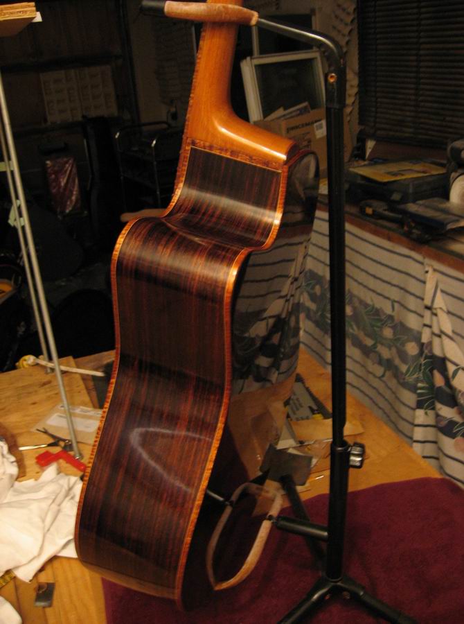

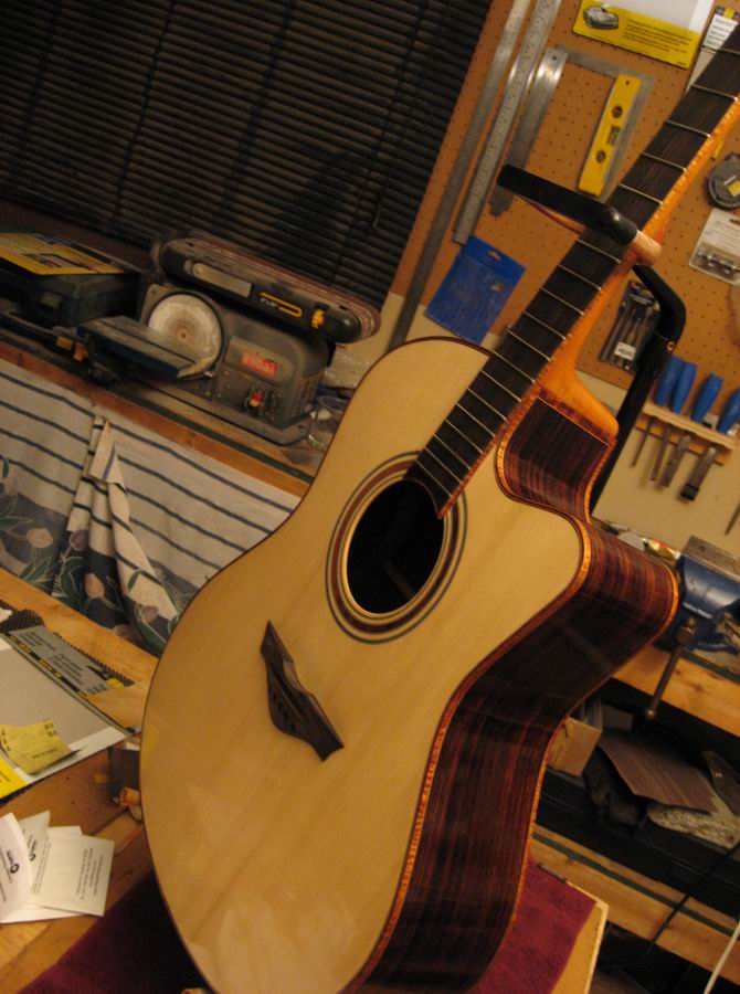

Alain - I never tire of seeing pictures of that guitar.

Well I do...    I'm trying to make an effort and always post new pics... but it's the same guitar!    Guess I should get cracking on no.3, eh?
