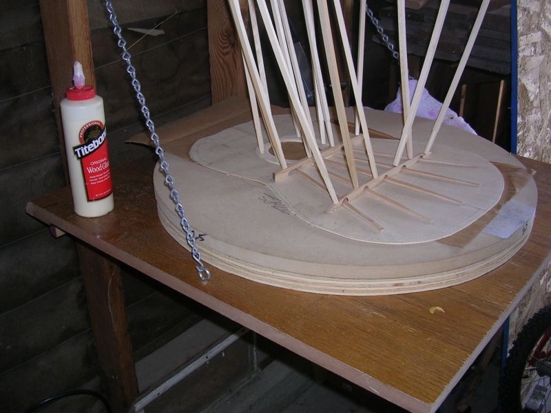

Be aware that you can also just use an existing bench and put an extra heavy duty braced shelf above it. Here is a photo of my current setup
Go bars are just scrap wood, mahogany and maple, that came from the rippings pile from my local wood supplier for free. I make both 1/4 x 1/4 and 3/8 x 3/8 bars for different pressure on various parts. You can also just add in a spacer block over a part to increase pressure a bit, but that isn't often necessary.
Alan D.
dunwell38971.6815740741

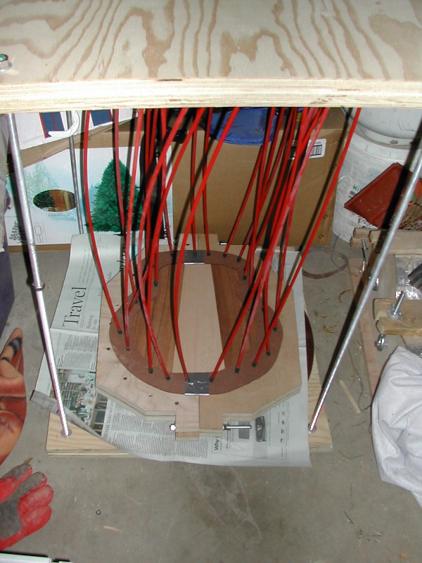

PostPosted: Tue Sep 12, 2006 1:02 am
[QUOTE=ToddStock] The StewMac deck works well, and is very rigid, which helps prevent flying go-bars. Also think the Into-the-Wind 3/16" rods and caps work pretty well.[/QUOTE]
Todd, I must agree, I got mine in the mail yesterday for Into the Wind (a kite store in Boulder) 48" long fiberglass rods, sawed in half with a hacksaw to make 24" long rods. The caps are 10 Cents each and slide on the ends. Cheap and effective.

PostPosted: Wed Sep 13, 2006 1:49 am
Economical wood dowels for go bars just don't add up in my personal experience for this one reason. wood fibers loose elasticity over time and break. Many hardwoods will last longer than others. And they do a good job but at $.50/ft fiberglass will last much longer.
Wood dowels are fine as far as the job they do. Hickory is in my opinion the best hard wood for this task but may be hard to find. oak is ok but fatigues quickly.
I have 24 2' 3/16 dia fiberglass rods and 24 varying height rods from 20"-15" all with rubber tips. It has cost me less than $50 for all my fiberglass rods. If I bought 48 3/16 or 1/4" hickory dowels I would spend close to or more for less working life.MichaelP38973.4514814815
