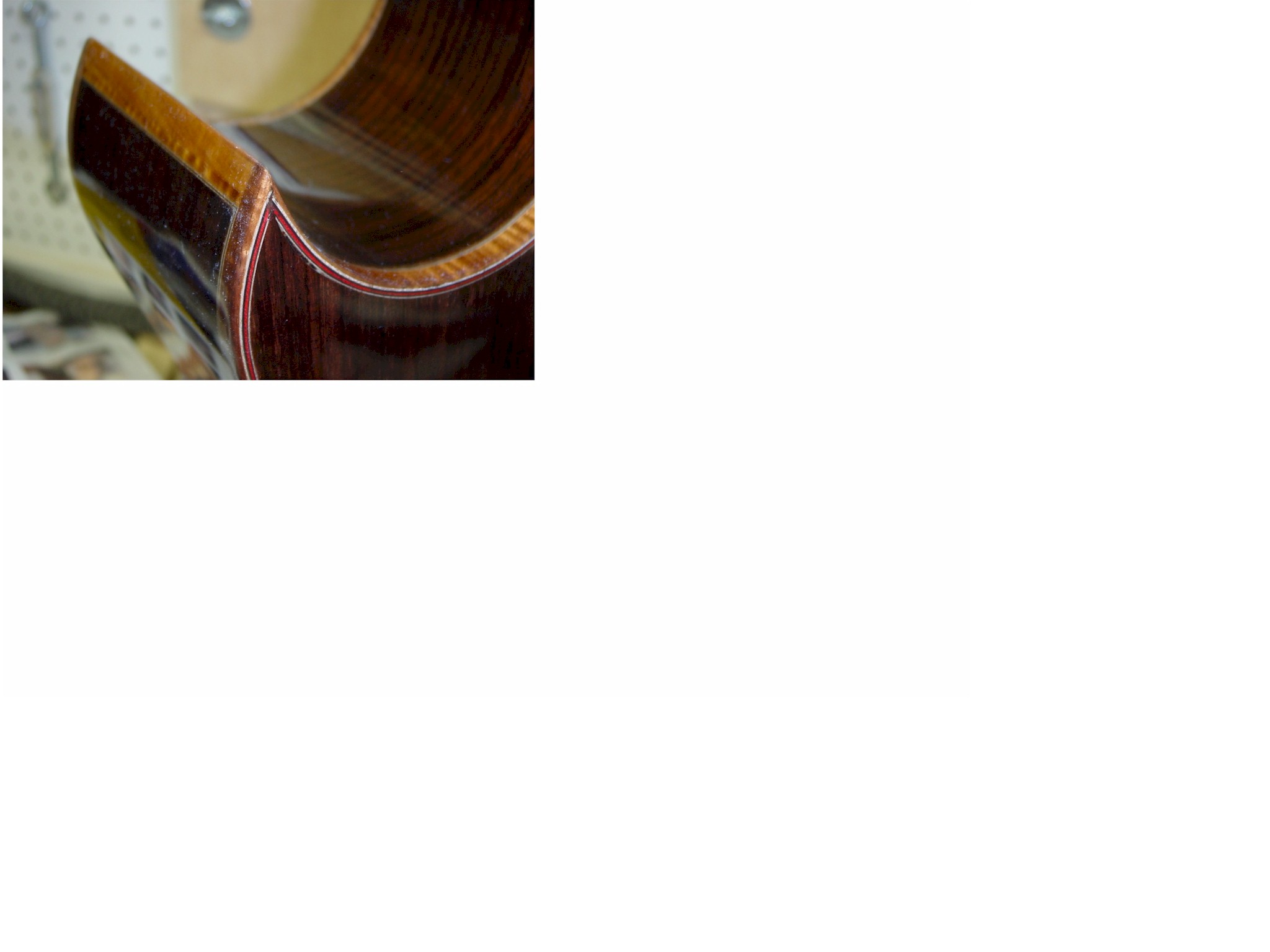

Thanks guys, but I guess the big problem is when I tape off the binding and purflings when glueing, the tape covers up the joints so as not to make them visable. I've put up a pic so you can see one of the "faulty joints". I thought I read somewhere that some luthiers tack with CA the corners (on headstock for instance), and then put them on with the miters all assembled. I had no luck. Maybe I just need more experience

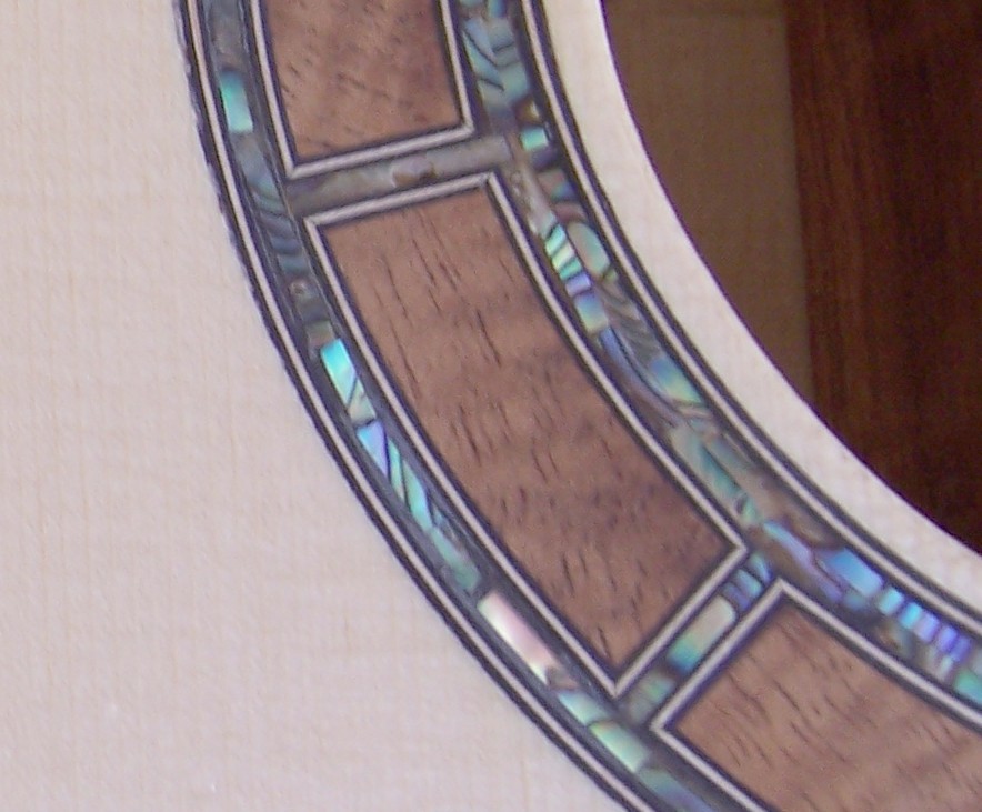

this process is easy on side purfling to end grafts where the purfling continiues to the neck joint because one end is open (not mitered under the neck joint) The tough part is when all edeges a closed defined shot lengths like this rosette
PostPosted: Thu Sep 14, 2006 6:19 am
Show off
That is sooooooo nice Michael, Try that on your 3rd guitar eh?
PostPosted: Thu Sep 14, 2006 6:49 am
There were only 12 of those Koa inserts. That is just 48 miters on the rosette, let alone the rest of a fully purfed guitar. I think there was a total of 62 purfling miters and 8 binding miters on this one.
in truth I cheated Mr. Murphy just a bit on the rosette. I have a micro miter saw that I set up a jig for each of the 3 lengths required to purf the Koa segments just to make the process go quicker.

[QUOTE=Mark Hanna] Thanks guys, but I guess the big problem is when I tape off the binding and purflings when glueing, the tape covers up the joints so as not to make them visable. I've put up a pic so you can see one of the "faulty joints". I thought I read somewhere that some luthiers tack with CA the corners (on headstock for instance), and then put them on with the miters all assembled. I had no luck. Maybe I just need more experience[/QUOTE]
There are 2 ways that I handle this.
1) there is a brand of clear 3M tape (I can get the product number for you tonight, or you could search on it) that will not stick to CA. So it is impervious and won't make a giagantic mess, and you can still see through it.
2) I tack weld all of my mitered purf joints with CA first then bind the rest of the areas. That is a huge help.

For your third guitar, it looks like the guitar came out pretty nice overall! As for the miters, perfection takes practice; don't get discouraged.
Probably the best suggestion I can offer is that if you have a flaw like this, rout it off and do it again right. And I'm not just talking about the miter. There is a significant gap between the purfling and the back near the tip of the cutaway, and the binding gets quite thin in that area as a result. With all the work you are putting into your guitars, you deserve a finished product that is free from these errors. (I hope this doesn't sound harsh; I'm sure you are already aware of these flaws.)
Everyone makes mistakes like these. Those of us who are new make more than others who are more experienced, but we all make them from time to time. What makes a crafstman is the determination not to accept the mistakes, the self-discipline to take it off and do it again right. As a newbie, you might have to do it again five or six times before you get it right, but that's how you learn. Only that determination and discipline will enable your guitars to make the transition from "homemade guitars" to "custom instruments."
On the practical side, here's a tip for eliminating gaps between the purfling and back like you have near the tip of the cutaway. Get some of those plastic Irwin clamps (Harbor Freight sells them, and so does Rockler) and, once you have your binding in place, use a clamp to pull the binding in tight in any areas with a tight bend. Usually, I put a tall, narrow piece of wood between the clamp and the binding so that the clamping pressure is focused right in the middle of the tight curve. If you have pre-bent the binding on a pipe or side bender, it shouldn't take much additional clamping pressure to pull the binding and purfling in nice and tight.

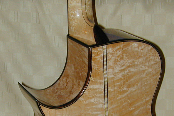

     One thing I havn't really seen addressed is the purfling must disect the angle exactly in half. Even if it's off just a few degrees it will show up readily.
     On a florentine it's obvious that it's not 90?. It's difficult to get the angle as the two surfaces are adjoining radiuses.
    There is the trial and fit method, which will get you there, but if you want a head start, get a protractor and find the exact angle and divide it evenly, with a little excess to work with.
PostPosted: Fri Sep 15, 2006 12:18 am
Here is a good tip for doing the mitre on a florentine point - dont measure anything !!!! the number of degrees the abgle is doenst matter. If you look at the picture posted above, there are two points that define the angle required, whatever it may be. This is how I teach my students to do them.
First, locate the two points - they are, 1, the outer point edge of the cutaway, and two, the point of wood of the back/top where the purfling will meet - so on hte photo abve, it the point of rosewood, where the inner blk/wh/blk purf was to meet. BTW, I have the piece of binding purf already glued in along the side, and it is hanging over the point of the cutaway - I am cutting this angle right on the guitar (I know, thats sounds scary - but if the chisel is sharp, rookies CAN do it)
So now that you have located these tow defining points, set the chisel edge just to the safe side of the line they define, and SLOWLY push down, controlling the chisel, keeping it striaght up, and remove the overhang, getting close to where the line actually is. Now ,ove the chisel in closer, and pare off some more. Then get right on the line, and clean it up. You are over half done, because fitting the cutaway piece into this one os easier, and can be done with a sanding disc. I will usually cut the angel on the p-urfling pieces with a chisel, fine tuning until the fit is right, obvisouly staring with pieces that are too long. Same with the binding, but I will sand it to fit. Once both are fitting dry, I tape up with the filament tape, and add drops of CA to hold it all in. Once that sets, you are now ready to tackle the next mitre, at the neck block in the same way (the cutaway bind/purf is left long and overhangs here as well). I wish I had pix, I will have to take some the next guitar that gets done this way. The beauty of this, IMO, is that you make each mitre fit before adding any glue, then once you have it, move on.
I am sure others do these differently, but this works for me, and my students have had great success with it.
