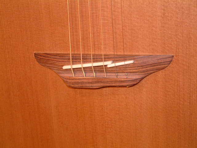

Here is how Mike Doolin does it:
http://www.doolinguitars.com/pinless.html
-C

Michael,
the J.Elliot style pinless bridge actually goes all the way down through the bridge patch pulling up on the patch and top almost as a regular bridge would...peterm38972.6470949074
PostPosted: Tue Sep 12, 2006 7:16 am
There are many variances. I just did not want J to not consider counteracting the shear load in case He wanted to use one of the premanufactured pin-less bridges on the market, similar to the type that Ovation puts on their guitars They are ok if bolted but I have repaired a bunch of early Applause and craftsman built guitars with generic pin-less bridges that did not have the two bolts tying them to the top and or bridge plate. They almost always pull of if not bolted down. My example loading example is of that generic pin-less type.
PostPosted: Tue Sep 12, 2006 7:25 am
Michael, I know exactly what you mean... thats why I did mine Elliot's way!

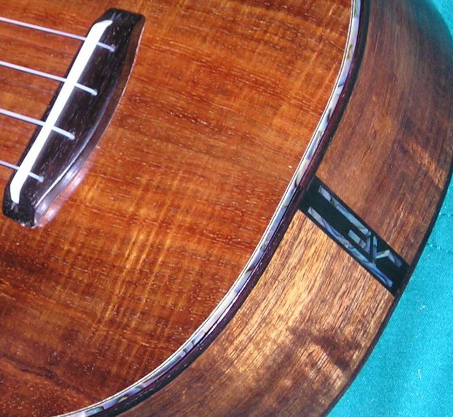

J,
I don’t know if this will help or not but pinless bridges are common on ukuleles. Here is a photo of a glyph ukulele with a pinless bridge. I would send a picture of mine but I’m not at home. Typically with the ukulele we just tie a large knot or add a bead at the end of the string because the end is just plain string.
aka konacat
