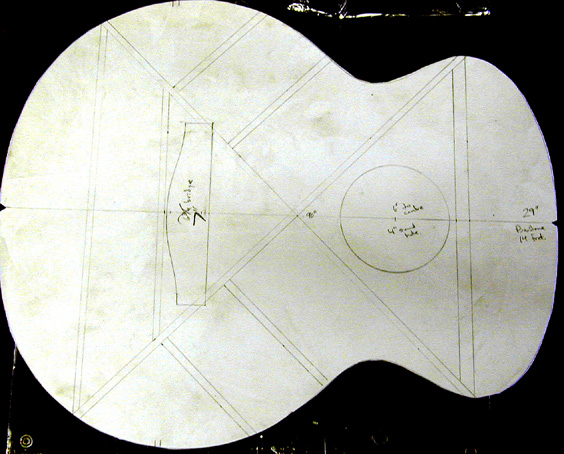

PostPosted: Fri Sep 15, 2006 6:53 am
Sorry no pix of the actual top braced up, but here is the 29 inch pattern.

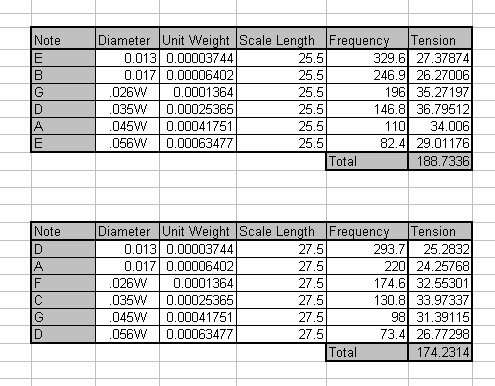

I ran through the calculations. Here is what I found based on that site and doing the calcs.
Increasing from a 25.5 to a 27.5 scale length, keeping the same diameter string at the same pitch increased tension 16.3%.
Increasing from a 25.5 to a 27.5 scale length, keeping the same diameter string dropping pitch 1 whole step decreased tension 7.6%.

I think you messed up in reading the chart - you can't do that for a baritone because the tension on the chart is calculated on a 25.5" scale length. To get the tension for a baritone, you have to do that calculations. SteveS38975.7684953704
PostPosted: Fri Sep 15, 2006 10:53 am
For Daddario EXP 23s, J brown is on the right track. The package back lists the B-B tensions for 29.75 scale, and it comes out to 233 lbs. Same strings at 28 inch is about 200, or about 25 lbs or so more than meds on a 25.4 guitar. I adjust the X brace height accordingly when building.

I check my calculations based on the site the J Brown posted - Here is the spread sheet. I now see that the length used is 29.75". The tension I get at that length is 204lb. If anyone wants the spread sheet, let me know and I'll email it to you.

Any errors in my calculations above? I've never done that before and am wondering if I missed something.
Thanks.
PostPosted: Tue Sep 19, 2006 1:24 am
[QUOTE=SteveS] Any errors in my calculations above? I've never done that before and am wondering if I missed something.
Thanks.[/QUOTE]
Steve,
Yes - those tensions look right. With bari's decide on your scale length and the tuning you want, then you can pick the best gauge strings. Baris can be anything from 26" to 30"+ scale length and tuned down anywhere from D-D to G-G so just because D'Addario sell a set of "baritone strings" it doesn't mean that "one size fits all".
