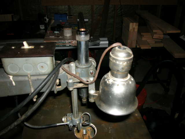

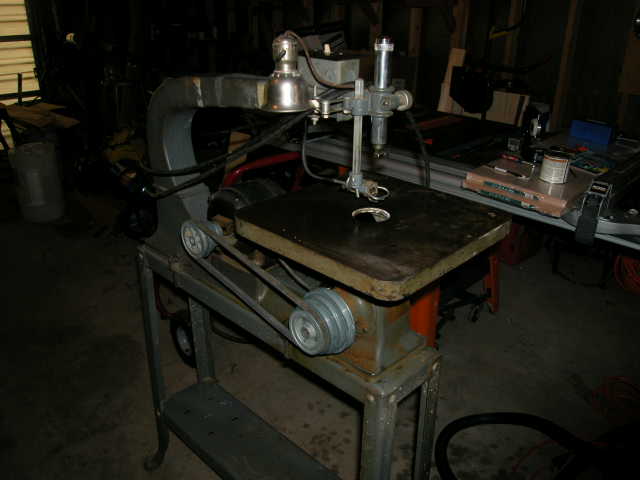

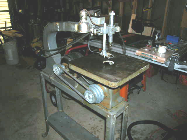

Thought you guys might get a kick out of this. Think there is enough throat to cut out a jumbo or dread?MT

24" throat, Delta.

Very cool find Mike, what year is this?

I haven't definitively checked. It is 40's or 50's. It works quite well and is a strange combination of a hydraulic driven pump and levers.The only part I may have to make is the center plate. Those I can easily turn from UHMW or phenolic on my metal lathe. I was able to download manuals from Old Wood Working Machines site. Darn, I love 30's-50's "heavy metal!" A scroller with this kind of backbone can do much of what a bandsaw will do- course twon't resaw. With the ultra thin blades and slow speed, it ought to help me cut out my "61"(TM)How do you like that funky little worklight on the scissors arm? By the way Serge,I'll PM with what's been going on- maybe Hesh too.Keep his mind off being "stoned."MT

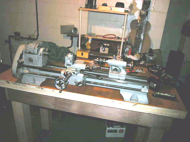

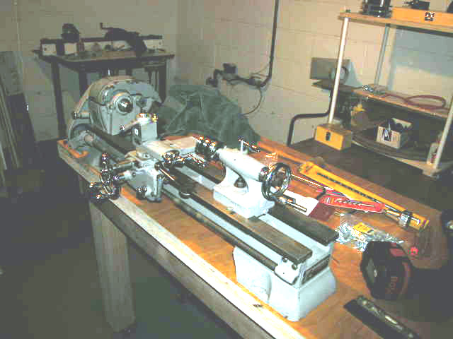

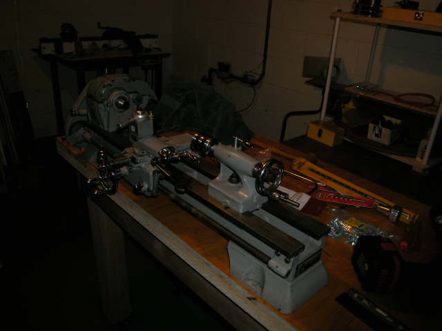

My Other 40's-50's Heavy Metal- John Watkins has one of these guys too. It is actually his only precision machine- he does his necks with this and its milling attachmentMT
     Little fellow to the left of "BB King" is "Buttons", the newest apprentice in the shop

Mike, looks like you're gonna make serious sawdust with these 2 monsters from the good ole days!

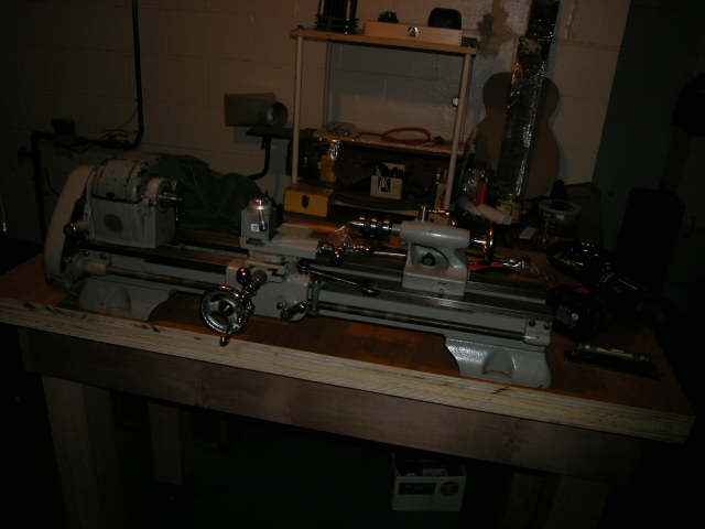

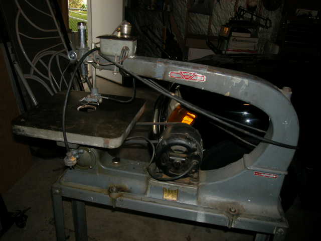

Lets throw some light on the subject.

Thank you Lillian. I haven't figured out how to edit/enhance my photos.MT
PostPosted: Sun Sep 17, 2006 12:12 pm
Mike, you are welcome. I have PhotoShop, so its easy for me.Aoibeann38977.8855092593

What make is your old lathe? Looks a little like a South Bend.
I cut my teeth on South Bends, and one huge WWII-surplus monster (don't remember the maker's name), and good ol' Bridgeport mills. Hard to beat the old iron.

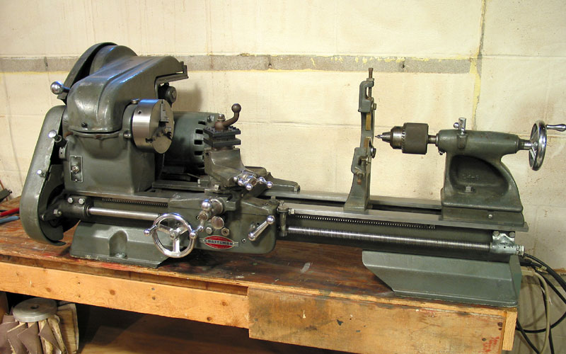

Michael, if I can answer for Mike, that's an early 1940's Sears Craftsman made by Atlas tool. Here's mine...

Mine is Atlas- same exact lathe but for the badge. They are called 618 in the Clausing/Atlas world and 101 in the Craftsman livery. I have modernized mine a bit.I am about to install my power unit. It is a 1.5hp DC, reversible high torque motor. And I have equipped it with a tach that converts RPM to SFM(surface feet per minute). SFM is the mode of measurement used on lathes. I have also adapted the Quick Change Tool Post to hold a tool rest for woodturning lathe chisels. The Atlas original manual devotes about 30+ pages to wood. This model, with Timken tapered roller bearings, holds up to high speeds well. I rebuilt my headstock with new bearings and cups - spindle has .00015 TIR cold. After run-in, I'll just barely tweak the pre-load and should have .001 warm. I have most all of the available accessories for it and a load of spares. My gear train has been upgraded to steel except for two Zamak Cast gears left as intentional weak point. I picked up a fine 1/40th hp motor,high torque also with high/low infinite(10 rpm to 2500rpm) speed variation and reverse. I will be able to use it for power cross feed- that was never available from Atlas.
       With the milling attachment I will be able to make brass wedges for my wood body planes. About the only factory accessory I lack is a tool-post grinder. However, there are much better options now including adapting a Dremel or Foredom. I will also be able to make bridge pins with that setup.
      And, I have the plans for a taper attachment scaled to the 6" swing/18" centers of this lathe.
    Clearly I have too many projects going at once.MT
