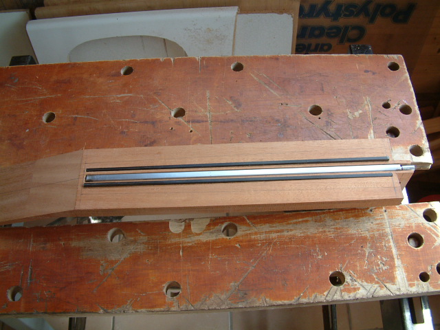

On my 29" scale bari's I use this gotoh 2-way truss-rod that fits just fine:
I get them from Touchstone Tonewoods here in England. It's the item 9587 in the page I have linked. I use the 410mm one (which is the length without the adjustment nut). I think they export to the USA if you can't find something similar in the States.

Perfect! Thanks a lot, Dave. Exactly the visual I was hoping for.
