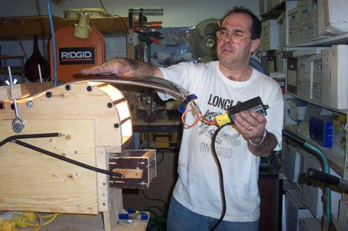

What Martin said, i built one with 3-200 watts bulbs and added the heat blanket after, the combination of both helps to keep the temperature steady on both sides of the wood, here's ma bender in operation, i have the thermometer that was supplied with the blanket by John Hall:
With the bulbs and the blanket it does get really hot!
