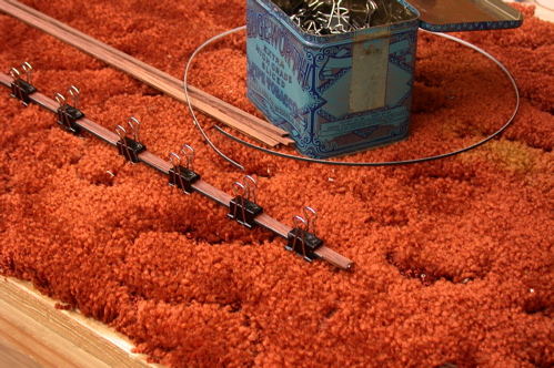

PostPosted: Wed Sep 27, 2006 7:11 am
I've finished exactly one side purfling job. I tried tape as Arnt suggested, but the cleanup was very time-consuming. Then I tried this
and had much better luck. I lightly waxed the inside of the clips just in case I got some glue on them, then was careful to drip the CA only on the areas without the clips. I hit it with the accelerator, then took off the clips and dripped glue on the whole thing again. Worked great, little cleanup.
PostPosted: Wed Sep 27, 2006 7:36 am
Thanks guys, exactly the info I was looking for!
Pat, I already have a bunch of the clips like in your pic. Maybe I'll give your method a go. Thanks!
