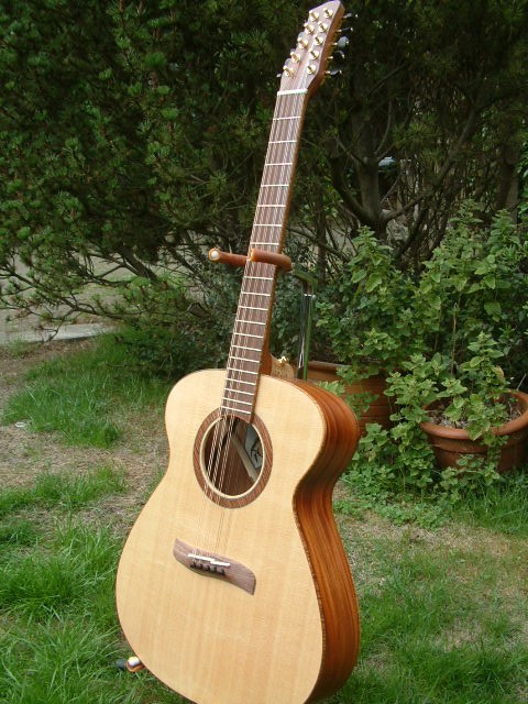

I recently finished a guitar cittern for Gavin Davenport of the band Heckety and documented the build on my website here:
The first things you have to think about are scale length and tuning (this will let you think about string gauges and overall tension) and then the body size/design. I decided on a Grand Concert size (which is close to your OM idea) with 16 frets clear of the body and a 24.9" scale length as that's what Gavin plays.

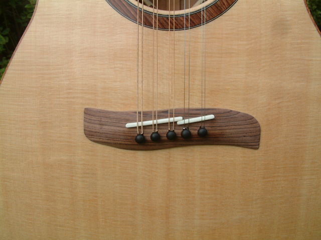

As for the bridge I went with five holes pinned with each pair of strings in each hole:
Neck design is going to depend on the string tension to some extent.
If you can get down to Hughenden Valley at any time I'd be happy to talk you through design etc. Or email/pm me.
