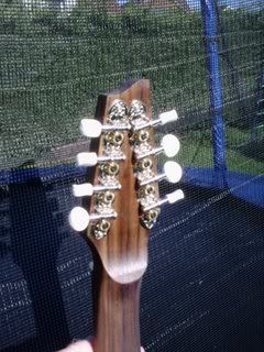

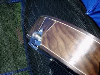

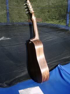

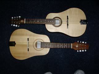

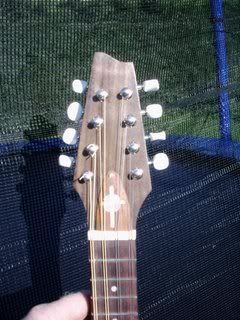

Build #9
A comission for the guy who didn't win the last one I put on Ebay.
Walnut back & sides, rosette, & neck
Spruce top (from Stewmac)
Rosewood fingerboard & binding
Maple purfling
Bone nut
Gibson style tailpiece from Chopper's Music on Ebay
Bridge is a Shadow Piezo pickup supplied by the customer
Tuners from Stewmac.
Jack/strap button is a switchjack from Stewmac
Finish is Danish oil. 4 coats, rubbed on, rubbed off, no wax.
The new one is the top one here.
