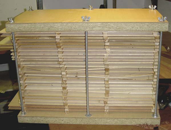

I use sink cutouts cut to size, some threaded rod, nuts, washers and wingnuts to suit and a big pile of stickers and I'm done. This way I not only keep my wood pressed nice and flat, it can be picked up and moved quickly and easily.
This is one I made for tops.
Now for me, having my stash mobile is a very important consideration, because if she ever discovers just how much all this stuff cost, I'm going to need to be able to tuck all of the important stuff under my arms, and make haste my escape less I befall some major injury
PostPosted: Sat Oct 07, 2006 1:28 am
WOW Kim, very clever way to stack, i love it!
PostPosted: Sat Oct 07, 2006 2:59 am
Kim, that's an excellent system! Plus, those sink cutouts should be available at any kitchen supply store for a nominal fee or for free.
