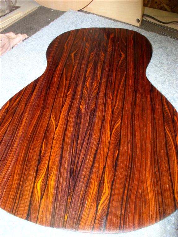

Kelby, you may have seen this, I don't know? But this is my first attempt at a four piece back, I think it looks great and have no problems about using it.
PostPosted: Fri Sep 29, 2006 12:54 am
Lance, I think you have a very fine eye for matching grain! Course it doesn't hurt that your back has more stripes than a Zebra!

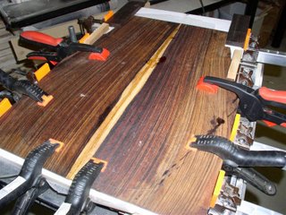

Martin, here is my set ups for joining plates,I use the same deal for back and sides.
LanceK38992.3525347222

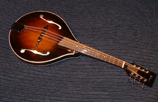

I think 4 piece tops and backs are fine. My first mandolin was made with leftover materials from various redecorating projects on my house. Like most wooden houses up here, my house from 1937 built with spruce (picea abies), and acording to the original owner it was actually logged at the property. So this mandolin has a 4 piece top that used to be wall siding, maple back, sides and neck from a door (?), the rosewood and ebony I probably bought.

Arnt, that was your first mando???!! WOW my friend, turned out real nice!

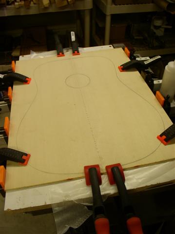

Well, I'd forgotten all about this thread till he pulled out a drawer that was actually his wedged joining unit and what was there to stop the glue sticking the board to the bottom of the drawer?
Yup, polythene.
I mentioned how I'd been pilloried by you guys and he says he's always done it like that!!!!
Each to thier own I guess, If y'all want to buy wax paper, rice paper or news paper that's fine, but being cheap I'll just use the poly bag that the AA Stewmac tops come it!!!
