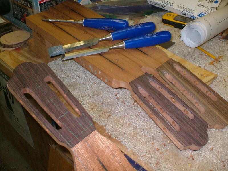

I've got a four piece set of Marples with the blue handles. I think they go by a different name now. I'm thinking of buying a better set so what do you use?

I have the same blue Marples that you have in your picture and I find that once they are sharpend they work fine. I also have some very cheap stanley chisels and I use these for glue squeeze out, scraping and other odd jobs where I don't want to risk my good chisels. Oddly enough the cheap Stanleys sharpen up to a very sharp edge very quickly. Sometimes I'll sharpen up one of them just to make a particularly difficult cut that needs the shapest blade I can get. It doesn't stay sharp but I don't need it to. I have some Two Cherries gouges and they also seem very nice.
