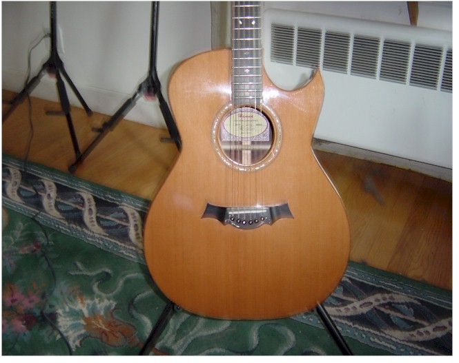

Hi Everyone, finished my first guitar. I'm happy with it
except a BIG MISTAKE! The bridge placement is off about 1/8th inch. Pics are not great, but here's where I need the experts, (you guys!). The intonation is off. The saddle needs to go back about an 1/8th inch. It's already an 18th inch saddle, and peaking it back isn't enough. I know the easiest way would be fill the slot and re-rout the s/slot. 2 problems are, the inlay will touch, (which I could live with), But the low E will be too close to the saddle break. If I move the whole bridge back, then I would have to fix the lacq. line, and then what about the bridge plate holes? I even thought about modifying the nut and step it back an 1/8th, but would look like #@$*. What advise can you guys give me? Should I move the bridge and fill all the holes in the bridge plate? AHGG!!

I would move the bridge back. Take it off, plug the holes with hard wood dowels, refinish and put the bridge back on.
Your guitar is too nice for you not to fix it right. You'll have that guitar forever.

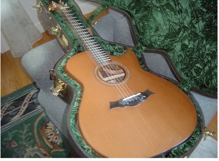

If you have not glued the fretboard extension yet, you may consider a neck reset. That is, add some matterial to the neck so it, in essence, sets the neck back, correcting the intonation. It will be way less notisable than messing up your great bridge.

I agree with Steve. You should pull the bridge, fill the holes, and move it and refinish. You will probably have a little lacquer line, but most will be hidden by the strings. It shouldn't be too bad refinishing that area since the bridge will be off. It's not like you have to refinish the whole top.
Another very important question...do you have enough bridge plate left to move it back 1/8"? In other words, will the bridge pins hit the bridge plate if you redrill?

One slightly off the wall suggestion as a fix. From the pics, the bridge profile looks big enough to make another one of the same shape (or fractionally larger all round) route the saddle slot in the correct position and have the bridge pin holes slightly further back to give enough string break. Take off the old bridge, plug the holes, refit the new bridge and re-drill.
That way you don't have to re-finish. If the bridge profile is a smidgeon wider than the old that gives you a little lee-way.Dave White38995.7436921296

Mark play it some then fix it (my fix )plane about 3/16 from top of bridge fill slot and holes graft new piece on top recut slot and holes= no finishing anyway great first guitar Mark.

I would do what Dave White suggests above. The new bridge would allow you to move the saddle to the right place and you could work the pins and inlay around that.

i would go along with those who say to remove and reposition the bridge. if the finish is nitro without any toners, which it appears to be, there should be very little trouble getting a finish with no witness lines, and remember that butyl cellusolve is your friend, so long as you don't make a practise of huffing it. an airbrush would be handy in the finish repair.
now that this unfortunate event has occured, take the time to sit back and reflect on your positioning routine to determine how the error occured and how to avoid it the next time. record same in your buid jounal and your construction sequence if you have one.

If it would be mine, I would put a 1/8 shim under the heel, a decorative purf line possibly. I assume this is a bolt on. This is the easiest and is fully reversible if you do not like the result.
The 14th fret will not line with the body, but this is not critical.
You can also make a new fingerboard with a scale 1/8 longer, and keep this one for a new project.

Nice job Mark. It is a shame about the intonation. I'm with Wade and Alain (in the minority) in thinking that adding a shim to the heel of the neck might be a little easier.

If you want to continue on this journey, there's going to be a time where you'll have to remove the bridge and touch up the finish on one of your instruments, so why not do it now? I think you'll be happier with that in the long run than with a visible shim on the heel (even if you try to decorate it). Besides, then you'll be available to help me when I need to remove a bridge!
